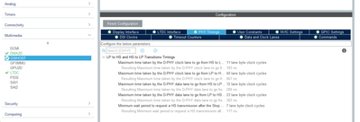

In relation to the HS to LS and LP to HS timings, could you recommend specific values?

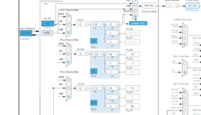

Uncertain about the necessity, I have an external oscillator operating at a frequency of 24.576MHz serving as the input frequency:
Any additional insights or specific recommendations you can provide would be immensely helpful.

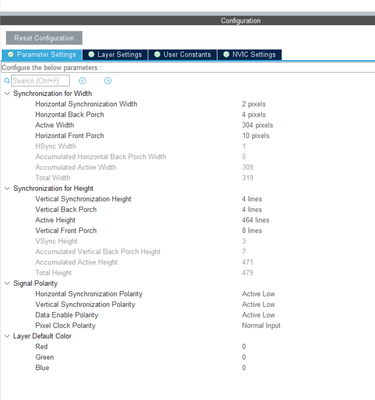

‎2023-11-29 9:56 AM
If you have a 320x480 don't set parameters for the active to be 304x464, that aint going to work
Are you sure the screen/buffer aren't rotated.

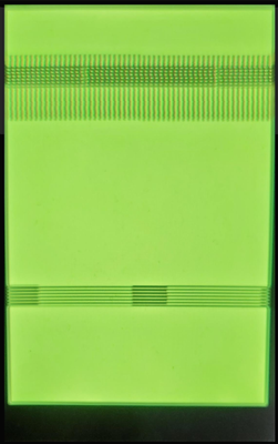

‎2023-11-30 4:18 AM
I appreciate your responses and insights into resolving the display issues we are currently facing. Based on your recommendations, I have a few follow-up questions to seek further guidance.
1. Debugging Frame Buffer or Geometry Issues:
Could you provide guidance on how to effectively debug and verify whether the observed issues are related to frame buffer or geometry problems? We want to ensure we address the root cause accurately.
2. Addressing Color and Line Distortion:
Attached is a picture of our display, which is not rendering as expected. Instead of a white color with clear text, we're experiencing color and line distortions in the displayed content. Any insights on rectifying this issue would be immensely helpful.

5. DDR Configuration and Clock Observation:
We are uncertain about whether our ST7796 controller supports double data rate (DDR). Currently, the clock observed on the oscilloscope attached to the MIPI lines is half the PLL DSI's configured clock.
Could be that perhaps with DDR, transfer data on both the rising and falling edges of the clock - the effective data rate is twice the clock frequency. Is there a way to disable this for the Stm32U5?

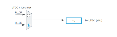

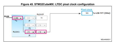

I do have one question: Could you clarify whether the Pixel clock being set there :
is equivalent to the LTDC Clock in my case?
I'm unable to locate the pixel clock setup in my .ioc file.
