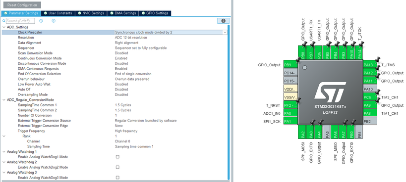

Hello, I need help with ADC and DMA settings. My application is VERY EASY but I do not understand the setup parameters. The application is that I just start CPU and the ADC raw value should independently transfer via DMA to variable. When I need the value (randomly) I just read the internal variable. I saw several youtube manuals but I still have 0 on output even when there is 1V. I use PA0 pin (ADC1, chan 0) on very easy CPU STM32G031. I need to use DMA Channel 4 (Channel 1 and 2 are used for USART_RX and TX)
My setup:
The generated code is like this (I use LL):

But how can I setup the variable where is the ADC result saved?
How can I start the ADC?
I tried to use ADC1->CR |= ADC_CR_ADSTART; and  reading ADC1->DR; but only zeroes...
Thank you

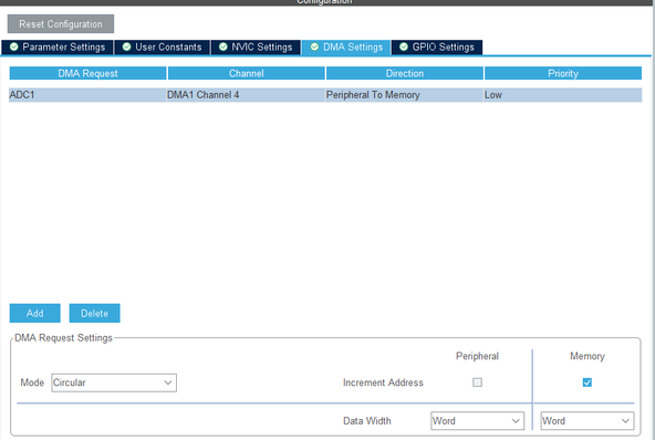

I tried to use HAL library. I exported this settings:
And added
uint16_t ADCACTValue;
  HAL_ADC_Start_DMA (&hadc1, (uint32_t *)ADCACTValue, 1);
but the result is still 0.

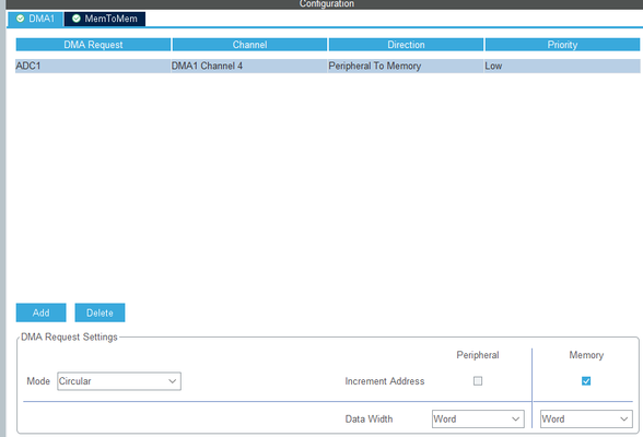

Stastny.Petr
Thank you, you are right, but I tested all. If I use (uint32_t*)&ADCACTValue then program code stuck.
I exported the code from CubeMX and when I use HAL_ADC_Start_DMA, nothing happens.
I tested again on NUCLEO kit with HAL and same problem. I am not able to use STM32G031K8 with ADC on DMA. I must say that I spent many hours on this and no result. I really do not know where is the problem - on STM32F103 it worked, but not on STM32G031.

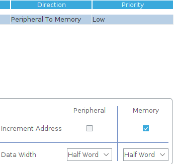

1. set pointer :  (uint32_t*)&ADCACTValue
2. DMA with transfer 1 sample is totally nonsense, as "circular" = in two blocks, how should this work with 1 sample ???  -> so make an array and transfer 100 samples or whatever, maybe circular with callbacks:
uint16_t sampels[120];
HAL_ADC_Start_DMA(&hadc1, (uint32_t *) &sampels, 100);
- Dont set circular - for only 1 transfer.
-- or dont use DMA , if you really want only one sample.
3. set half-word access:
4. Use HAL , not LL . (Anyway same speed : if DMA used, this is the speed of the DMA then. HAL or LL or bare metal will change just the setup/call time , maybe 1 x 1 us more, when using HAL. This is nothing to think about..)

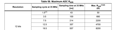

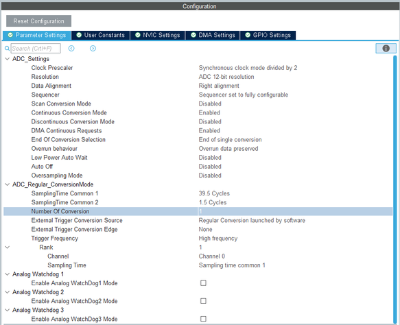

Output impedance of my source is around 1 kiloohm, so not very small. Am I correct that in this case I need to setup as sampling time as possible?
Is necessary to have 160 Cycles?
Sampling time about 160 Cycles means on 64 MHz conversion time around (1/64meg * 160) = 2,5 us?
The cycles here are on adc-clock , not cpu-clock. So if adc at 32M -> 5us .
from ds:
need about 200ns for < 2kohm input , so at 32M adc clock 7.5 sam.cyc. setting should be ok;
Tconv then 20 cyc /32M -> 0.6 us .
