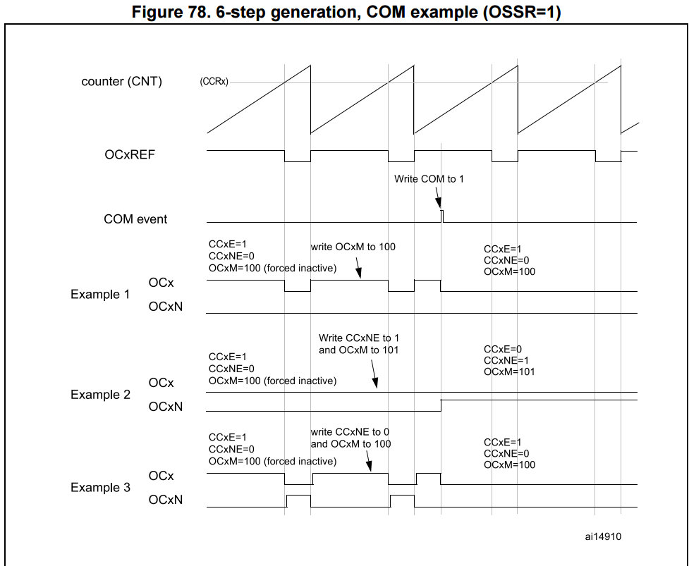

Hi there, thanks for your response. I don't that will work because that resets the polarity bits of the CCER register and only would modify the enable/disable bits for the signal output pins. But I found something what might be the cause of still receiving a signal at the pin. In the data sheet for CCER register it's written: "Bit 2 CC1NE: Capture/Compare 1 complementary output enable 0: Off - OC1N is not active. OC1N level is then function of MOE, OSSI, OSSR, OIS1, OIS1N"
When CCER is 0, it is then the function of the other bits in the BDTR register. I have set OSSI as 1, that might be driving the pin because I have set CC1NE to 0. That stays there. Next, what I found is that I might be implementing the 6 Step approach in a wrong manner, I looked over the datasheet again and this figure below says that I must also manipulate OCxM bit along with CCxE and CCxNE bits. I am not experienced much to understand this figure, would it be possible if you could give a brief overview of what's happening, I am just confused over the CNT, I mean why does COM event happens in the middle of CNT, after CNT reg has counted fully for 2 cycles before, already? Also for example 2 in the figure below, when OCxREF goes to 0, OCx and OCxN stay as it is. Later in the same example CCxE is set to 0 and CCxNE is set to 1, CCxNE rises but why does CCxE stays at the same level?
