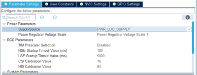

Vcore is at zero. On power-up, but NOT after hardware reset, there's a momentary blip on Vcore followed by a decay to ground. Somehow-or-other, the power supply setting was set for SMPS....and we're not using the SMPS. All of that is grounded. We had to go searching for this setting, and neither of us knew where to find it so it's a mystery how it got set that way. It should have been set to PWR_LDO_SUPPLY, which enables the internal LDO for Vcore and disables the SMPS.
Once you've done this, there's no way back without finding a way to power Vcore externally, or scraping the part off the board and replacing it. In my case, I grabbed a LM117 adjustable regulator and tacked the adjust pin to ground and the supply to 3.3V. That sets the output to 1.25V, which I could then hotwire to the Vcore cap. Blinkylight! Hurray!
So.....if you're not using the SMPS, and you don't have an external source for Vcore, it's critical to make sure that the power supply is set to PWR_LDO_SUPPLY. You'll find this in CubeMX under the RCC settings. That is not where I would have expected to find it, and we had to fish around for a while before we tripped over it.

To recover your "broken" chips, you can follow the steps described in this article.

Seems to me that this should always default to LDO_SUPPLY
I agree.
I had it his way around, programming the H735 on the eval board with the SMPS to use the LDO - which worked most of the time, and more important: it didn't kill the STM32, and it was easily re-programmable via ST-Link.

Perhaps you're right, but when you've used a tool for years with various different processors, and never had a problem, you tend to trust the results. We'd used this processor on one project previously and didn't run into this problem, so it's a bit puzzling why it worked then, and didn't work this time. I'm wondering if something changed in the latest update to CubeMX, such that the default power supply mode was different.
We've done dozens of STM32-based designs (maybe a hundred by now?) with parts from across the range from the F103 to the H735. We're very familiar with the datasheets and reference designs.
The BOOT0-driven-high trick is interesting....that should put the part in DFU mode, but I was unable to get its attention that way. I have a pushbutton on the board for that purpose, but no combination I found was able to get the LDO to run long enough to get it out of reset and connect with the debugger. I'll play around with that a bit more on the next board, where I will re-use one of my 'bricked' CPUs.
