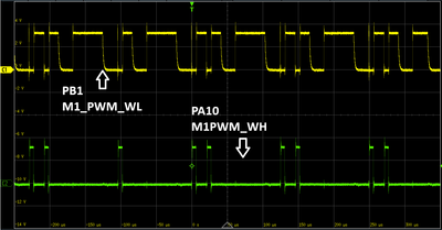

Problematic Behavior:
When I try to start the motor through the Motor Pilot, the PWM output looks glitchy and irregular (see appended picture), and after a few seconds, the Motor Pilot reports "Port Open but no answer from the board." Note, I have not even connected the Nucleo boards and IHM11M1 board together at this point. I'm only using the control board.

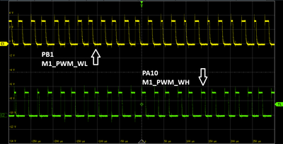

The expected behaviour/output is shown in the picture below and I got this from a project using a F401RE nucleo board.

-) My first thought was that the application was still overloading the MCU. In an attempt to minimize the workload for testing purposes, I tried lowering the PWM frequency to 2 kHz and running the 6-step algorithm at a period of 5 times the PWM period (3 ms intervals).
-) I compared the generated IOC file for the F401RE and the F030R8 projects. The only difference I saw and could not explain was that in the timer 1 settings for the F030R8; the generated configuration from the MC Workbench did not preset the clock source to be used. I've tested setting it to use the internal clock.
-) I tested generating the project using both HAL and LL drivers for the peripherals.
-) I've created an inverter board using the recently released board designer for the MCU sitting on a Nucleo - F031K6 with the same resulting PWM outputs.
None of the tested countermeasures improved/noticeably changed the generated PWM outputs and the motor pilot behaves the same.

Thanks for taking the time to answer my post. I would be surprised if this is the issue. In the release notes of the X-Cube-MCSDK 6.3.0, ST states they've added support for the six-step algorithm for the F0 series. Also, in the same document, ST states that all F0 MCUs are supported by the Motor Control Workbench, which generates the IOC file that configure the peripherals needed. So my thinking is that this should all be properly handled by the pipeline.
