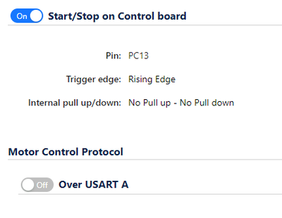

Not using the MC Pilot so I have the following in User Interface:
For the first part of the application, I was passing 'SH\r' to start the motor and 'MO\r' to stop the motor.

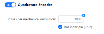

I have the following BLDC motor:
BL17E40-01 | BL17 Series | BLDC Motor | Lin Engineering
and I have installed the following encoder:
AMT11 Series | Modular | Incremental | Rotary Encoders (cuidevices.com)
The problem I think is these are relative encoders, and the MC workbench calls encoders with Z pins as absolute encoders.
I want to extend my user application and send commands that move the rotor to a particular position in some time.
