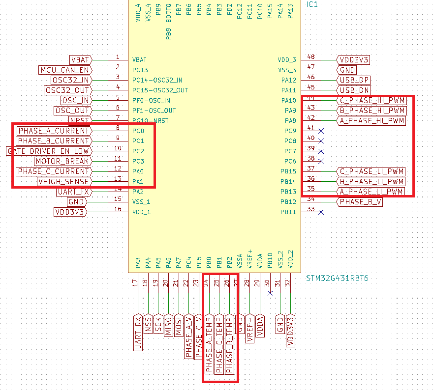

I have developed a custom control board and a custom power board. I am trying to add them to MotorControl Workbench 6.1.1 and I have written a custom JSON files describing both board. A few interesting things:
I am using STM32G431RBT6 as my MCU, the NCP51820 is gate driver and the current is measured with ACS772ECB hall effect current measurement IC. And the this is how it is connected to the MCU, most important connections are marked in red.

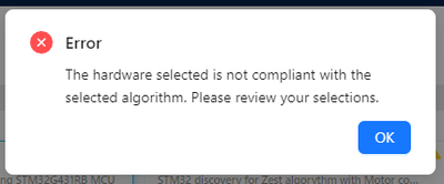

I am getting
Error
The hardware selected is not compliant with the selected algorithm. Please review your selections.
When I try to start a project. I have made a two decisions because I did not know what else to do.
The first is I can't see how to add e custom connector, so I used  MotorControlConnector type.
The second is I can't see hall effect sensor type for current sensing and I chose ThreeShunt_RawCurrents_SingleEnded
Can anybody tell me what I am doing wrong? The MotorControl Workbench 6.1.1 is not very descriptive. On semantic check all is good. The JSON is valid and all of the features properties are set. Do you need any other information to help?

Hello Dimitar Dyakov,
As you are using a hall effect current measurement IC, the correct type for current sensing would be TwoICSCurrents.
You can find the dedicated section in the board description wiki right here.
If you agree with my answer, please consider accepting it by clicking on 'Accept as solution'.
Hope this will help,
Gaël A.
Hello @Dimitar Dyakov ,
To complete Gael's answer, the selected hardware variant for current sensing:  ThreeShunt_RawCurrents_SingleEnded is dedicated to sense non amplified current and making use of internal Opamp to do the amplification internally.
Our implementation with hall effect current measurement makes use of only 2 phases. That's why so far, we propose only TwoICSCurrents.
Let us know if you succeed to generate your project and spin your motor.
Regards
Cedric.
It seems that both files are identical, so I started from the first version you posted (power.txt).
I attach to this post a Zip file containing both descriptions. I succeed to load them in the WB, generate a project and generate a binary from the generated project.
Don't forget to update the "icsGain" parameters according to your hardware.
Best Regards
Cedric
