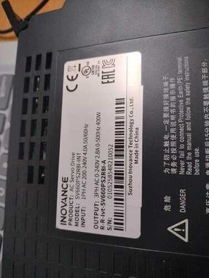

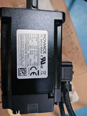

I am New for this domain(embedded systems), Currently i am doing robotics for some Motors(stepper, DC Servo, pumps and DC geared Motor), Now i started to writing the code for Alternate current servo motor. Herewith i have attached the reference of motor and driver,
I am using this type of servo is lifting up and down motion. whenever i run this servo motor at same stepper motor is also not working, but one by one working fine, These codes i have modified from the stepper motor code. The stepper motor is controlled by working in half mode. The servo motor is controlled by working in full mode.
Please find the attached main file, CPP file and main file.
Kindly help me on this issue. I am Using Keil Studio Cloud Software.

Servo Drive1200×1600 189 KB
Servo Motor1200×1600 167 KB
