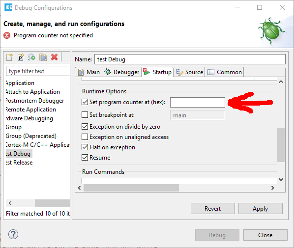

I have an existing stm32f439vitx custom board project which works fine when flashed at address 0x08000000 which I now need to make runnable from an existing bootloader expecting the program to have been flashed at address 0x8008000.
Is it enough to change the linker script ROM origin and length?

Hello again @berendi​
I finally got around to trying yout "arrange the Reset_Handler to start at 0x08008200" solution. I made the modifications you suggested, when I build though, I get the message
Invoking: MCU G++ Linker
arm-none-eabi-g++ -mcpu=cortex-m4 -mthumb -mfloat-abi=hard -mfpu=fpv4-sp-d16 -L"C:\Users\david\workspace\divecomputer.eu_hal_lib\Debug" -T"C:/Users/david/workspace/flash/LinkerScript.ld" -Wl,-Map=output.map -Wl,--gc-sections -fno-exceptions -fno-rtti -o "flash.elf" @"objects.list" -ldivecomputer.eu_hal_lib -lm
c:/ac6/systemworkbench/plugins/fr.ac6.mcu.externaltools.arm-none.win32_1.17.0.201812190825/tools/compiler/bin/../lib/gcc/arm-none-eabi/7.3.1/../../../../arm-none-eabi/bin/ld.exe: flash.elf section `.mystartup' will not fit in region `ROM'
makefile:52: recipe for target 'flash.elf' failed
c:/ac6/systemworkbench/plugins/fr.ac6.mcu.externaltools.arm-none.win32_1.17.0.201812190825/tools/compiler/bin/../lib/gcc/arm-none-eabi/7.3.1/../../../../arm-none-eabi/bin/ld.exe: region `ROM' overflowed by 132174580 bytes
collect2.exe: error: ld returned 1 exit status
Do you have any idea what might make the linker think that the tiny "mystartup" section is so huge?

@berendi​
Fantastic stuff! The linker .map is showing the mystartup section with Reset_Handler at 0x08008200
It still runs fine in the debugger, although not from the bootloader, but I'm guessing that that's pretty much my fault at this point.

Start the bootloader from the debugger.
Find the debugger reset vector, which is stored at 0x08000004, and use the value found there as the start address in the debug configuration dialog (hope it's there in system workbench too).
Then put a breakpoint on the application reset handler, main, etc to see how far it gets.
