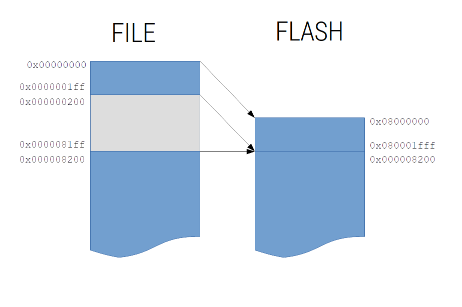

I have an existing stm32f439vitx custom board project which works fine when flashed at address 0x08000000 which I now need to make runnable from an existing bootloader expecting the program to have been flashed at address 0x8008000.
Is it enough to change the linker script ROM origin and length?

Well well. It looks like I've found the problem.
It turns out that a huge great chunk of the .bin file is surgically removed before being sent to flash (see the picture) as part of a preprocessing step.
I'm surmising that the original firmware programmer didn't know how to compile his code for address 0x08008000 so he compiled for 0x08000000 and managed to convince the linker to put in 0x8000 unused bytes straight after the vector table. The bootloa
The bootloader itself is basically ok, but my problem now is that, for other reasons, I have to use the exact same preprocessor which means that I'm going to have to find a way to duplicate the same .bin file layout. Do you have any ideas on that one?

Ok, so it seems to me that what I need in the .bin file is 512 bytes of vector table at 0x08000000 to 0x080001ff, followed by 0x8000 bytes of space from 0x08000200 to 0x080081ff, followed by the rest of the code from 0x08008200, with the "Reset_Handler" being the first part of the rest of the code.
The vector table will end up being flashed at 0x08008000 to 0x080081ff and the rest of the code exactly where it expected to be.
I can see why your setting the origin back to 0x08000000, but I'm a bit lost with the sections and so on. Is that what your mod is doing?

So. Here's what I know (remember, the bootloader does one of two things, it either jumps directly to the firmware or downloads the firmware and then does a reset which triggers jumping directly to the bootloader):
(0) The bootloader does some inexplicable chicanery with the vector table pointer and the stack pointer before jumping to the firmware.
(1) I build my firmware for address 0x08008000 with the reset handler at 0x08008200 and SCB->VTOR to 0x08000000 and then program it into flash manually at 0x08008000 using ST-link. Resetting runns through the bootloader's "jump to firmware" and starts my firmware, confirming that the bootloader's initialisate, deinitialise, jump to firmare functionality can execute valid binaries at 0x08008000.
(2) I build my firmware for address 0x08000000 with 0x8000 bytes padding from the end of the vector table through to the start of the code (so at 0x08008200), set SCB->VTOR to 0x08000000 in the reset handler and then program it into flash manually at 0x08000000 using ST-link. Resetting the MCU executes the firmware directly, confirming that my firmware works with the vector table at the start of flash and the code at 0x08008200.
(3) I manually strip the padding byte section from the bin file, let the bootloader program the flash and compare my stripped binary to the memory contents at 0x08008000. The first 0x200 bytes of .bin are now at 0x08008000 and everything from 0x8200 onwards in the file is where it would have been anyway, (tentatively) confirming that the binary starting at 0x08008000 is valid.
Needless to say, it doesn't work. So, given (1), (2) and (3), I conclude that shifting the vector table from 0x08000000 to 0x08008000 has somehow broken something.
