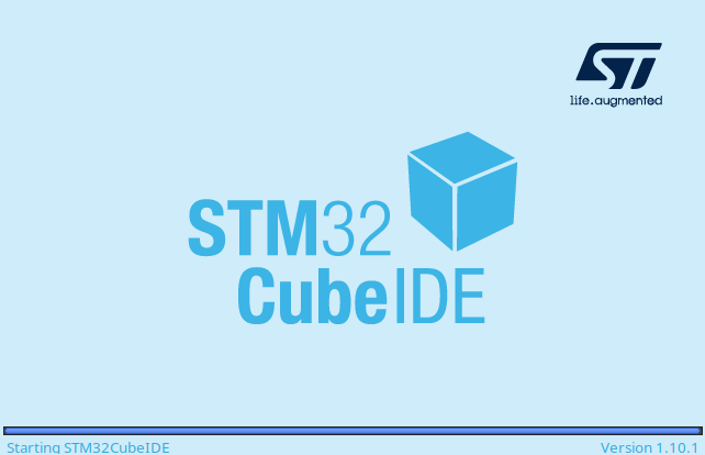

starting IDE , stays here:
0693W00000aJG4aQAG.pngonly kill with taskmanager possible.
problem exist when starting IDE today, yesterday and before was no problem.
yesterday i closed it as usual and shut down PC.
today - no start. but when i choose other workspace, it is starting. (but no projects there).
so: how to get workspace working again?
