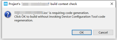

Nico4
Thank you for your reply.
Actually, I found that Once I set the "isbadioc=false" in ioc file, the problem will be solved.
Otherwise, if set  "isbadioc=true", the problem will occur again.
And the main problem is that line:
"at com.st.stm32cube.common.logger.MCULoggerPlugin.openConfirmDialog(MCULoggerPlugin.java:292)"
So I tried to compile the project in GUI,  Once I click build button, this confirm dialog will show. And it will prevent the non-GUI build proccess.

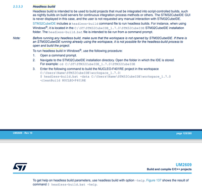

Ghofrane GSOURI
Hello @Nico4
Here are a few suggestions to address this error:
1-Check workspace metadata: The error may be caused by corrupted workspace metadata. Try deleting the .metadata folder within your workspace directory. This folder contains various settings and configuration files for your workspace. Deleting it will reset the workspace settings, but keep in mind that you might lose some workspace-specific configurations.
2- Try a new workspace: Create a new workspace and import your project into it. This can help isolate any workspace-specific issues that might be causing the error. To create a new workspace, use the -data option with a different directory path when running the command-line build.
3- Clean and rebuild: Perform a clean build of your project to ensure a fresh build from scratch. Use the clean option before running the build command. This helps eliminate any potential conflicts or inconsistencies from previous builds.

Nico4
