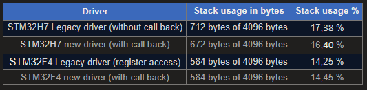

Hi @Pavel A.​ ,
Thanks for your valuable input.
We double checked the point about callbacks and potential impact on stack usage.
As you can see in table below, the stack usage with callbacks method is even better than the legacy model, so we think there's nothing to worry about at least from this side.
Another check has already been done also on CPU load with positive results (no impact of the new driver on the overall CPU load).
Regarding the point of architecture (Separation of the driver and higher/app/middleware level code could be more elegant and robust.):
It makes sense. But, actually our major constraint and main concern is the memory allocation which is done in application level (ethernetif.c), so there is a need to know how many allocations have been done. And if the number of allocations is managed inconsistently we fall back in the issues faced in legacy ETH HAL driver.
Which means this architecture was necessary to solve that particular problem. So I agree that a separation of the driver from high layer would be more elegant, but it would be less efficient in solving the main problem.
Please don't hesitate to comment/feedback.
Kind Regards,

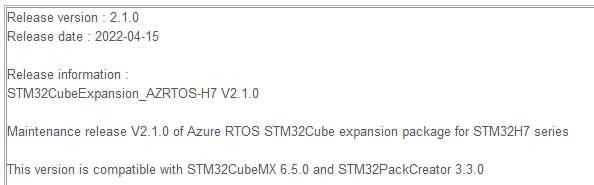

Hi Chekib Hammami,
Do you already have a precise date when the X-CUBE-AZRTOS-H7 update will be available?
‎2022-04-13 6:29 AM
Hi @Community member​ ,
The package is ready and will be published early next week on both github and st.com.
Kind Regards,
‎2022-04-17 7:06 PM
Hi Chekib Hammami,
I also updated AZRTOS-H7 to V2.1.0, it still complains the compatible issue. My cubemx version is v6.5.0.
‎2022-04-18 12:41 AM
Servers sync might take some time and then this warning message will disappear from STM32CubeMX 6.5.0.
Kind Regards,
