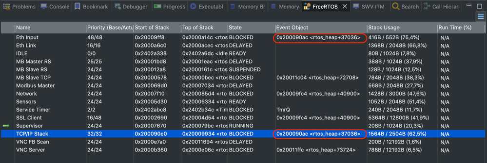

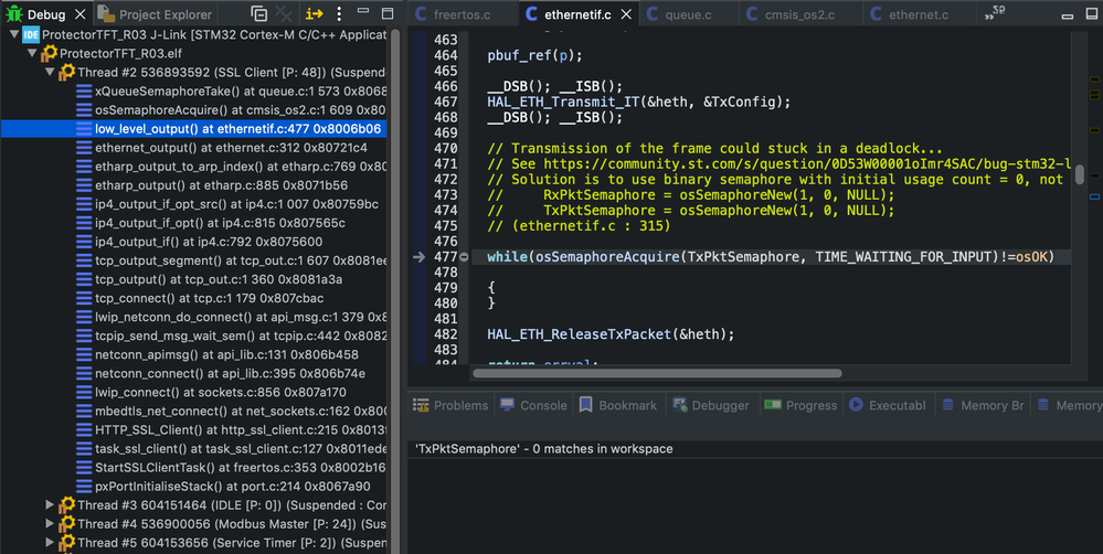

ktrofimo
Senior III
Oct 4, 2022 4:23 PM UTC
 /* create a binary semaphore used for informing ethernetif of frame transmission */
 TxPktSemaphore = osSemaphoreNew(1, 0, NULL);
void HAL_ETH_RxCpltCallback(ETH_HandleTypeDef *handlerEth)
 osSemaphoreRelease(RxPktSemaphore);
Still locks :(
ktrofimo
Senior III
Oct 4, 2022 5:07 PM UTC
Update:
Both TCP/IP task and Eth input task both are blocked at the same event object 0x200090ac0693W00000UnKyYQAV.png

PiranhaAuthor
Principal III
Oct 5, 2022 5:49 PM UTC
https://github.com/STMicroelectronics/STM32CubeH7/issues/224#issuecomment-1199200853
It seems that you are still using the ST's broken link detection code. I've pointed it out and explained what is wrong with it in my main Ethernet & lwIP issue topic since the beginning and I am repeating it again and again, but nobody is listening. ST, forum users and almost everyone just keeps silent and pretends that those issues doesn't exist. It's a mass insanity!
To fix it, you can get inspired from these links:
https://community.st.com/s/question/0D53W00000zHH9PSAW/changing-ip-address-mac-address-during-runtime
https://github.com/stm32-hotspot/STM32H7-LwIP-Examples/blob/b4bcc6cffa109ff44b875165b5cd5aec04f5df22/STM32H743_Nucleo_ETH/LWIP/Target/ethernetif.c#L798
P.S. I cannot know whether your other threads, which are using lwIP API, respect the rules.
