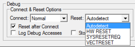

Hello
There are several ways to RESET a Cortex-M processor.
uVision (and others) support these: See the picture below:
This is in the Debug tab. Select Help in this window and then select Debug at the end of this document.
Some people find one of these selections useful especially with custom boards.
Under Connect is a new feature to connect to a running target without stopping or resetting it.
Bob
