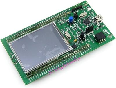

Will my gpio pin gets effected if I give a voltage of 4v because my board Is not working it is getting heated once i connect the supply through usb.

1) I'm using Stm32f429 disc 1 board
2)I wanted to measure a signal using internal adc with reference voltage of 3.3v . The gpios I'm using are pa2,pa3,pa6 all are of different voltages of 2.7v, 2v and 4v.
3) Suddenly the board stopped working and it's showing st link not detected when I start debugging.
‎2024-07-19 7:14 AM
Pins are not 5V tolerant when they're in analog mode (e.g. being used by the ADC). Putting them above VREF can damage the board.
If you remove the voltage and the board works okay, good, but something may have been damaged.
‎2024-07-19 8:01 AM

You've over-stressed the part.
Over-stressing won't necessarily cause immediate failure but the longer you keep it over-stressed, the more likely it is to fail.
Same as if you overload a car - you might get away with it initially but, sooner or later, something will break.

Or you had a poor ground connection between your assorted supplies, and the electrons found a different path with a much more significant potential difference..
3) Learn through failure, purchase a new board. Have better isolation, and read data sheets.
