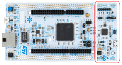

@bramble wrote:
I read (here) that it's possible to use a Nucelo board's in-built ST-Link Vn debugger to program/debug a custom STM32 board. However, I have a doubt about this.
This is true of the Nucleo-64 &-144 boards which have the break-off ST-Link section.
But it seems that some newer ones don't have this - and don't make it easy to use the onboard ST-Link with external targets.
As @Mike_ST said, how to do it will be in the UM for those boards which support it.
@bramble wrote:

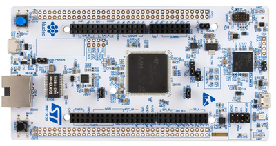

I have available two Nucleo's: STM32F429 and STM32H755,
The Nucleo-F429 does have the break-off ST-Link:
The Nucleo-H775 does not have it:
Mike_ST
Maybe it is not needed to break the PCB, removing the IDD jumper to disable the stm32 might be enough.
Never tried myself.
But that still leaves the onboard target microcontroller connected to the NRST, SWD, etc lines ...
The thing that's lacking on these "new" Nucleos is the facility to disconnect the onboard target from the ST-Link.
Maybe holding the onboard target in reset would be sufficient?
There was a thread on this recently: as someone said there, it should be possible - but not easy.
In these cases, I think the price of a separate ST-Link becomes worthwhile...
