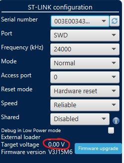

I have the STLink V3MINIE. When connected to the PC the red power LED is on. But I can't program any device because there is not target voltage.
ST Prog (v2.17) shows Target voltage 0.00 V
How can I fix this? Is there a jumper or solder connection missing on the stlink? Or is the board damaged?
Thanks for help!

We will use the TagConnect TC2030 https://www.tag-connect.com/product/tc2030-ctx-nl-stdc14-for-use-with-stm32-processors-with-stlink-v3 to connect the stlink v3minie to the PCB, that's why the power on the T_VCC pin is needed. I think, I will find a solution to achieve this.

You need GND, SWDIO, SWCLK;
Useful to have are also NRST and T_VCC;
So that leaves you one spare to use as a supply to your target
Yes, they are very handy. All the essential signal are there, also SWO. I will try to wire the 3.3V to T_VCC on the stlink v3minie board as I mentioned above. Than it should be possible to program the pcb if not mounted to anything else.

I’ve just realized that debugging will not start without detecting the target voltage (pin 3 connected). This voltage is likely required by the level shifters. My custom probe doesn’t provide the target voltage, since I can use only four pins, and in addition to GND, SWDIO and SWCLK, I need TX. Below is working workaround I just tested.
Needless to say, this solution can be used with 3.3 V system only. I purposely used older STLINK-V3MODS because it is easier to modify.
Indeed.
