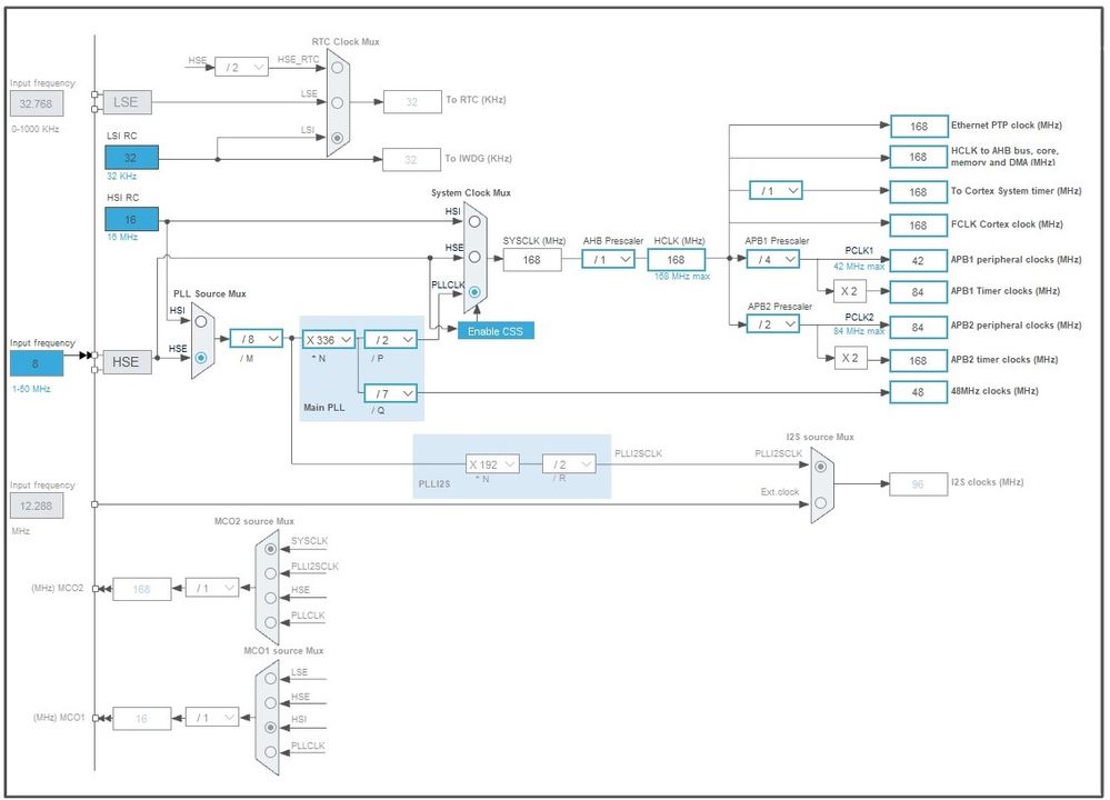

Concrete worked example — STM32F4 (HSE = 8 MHz → SYSCLK 168 MHz)
This is the canonical example many projects use. I’ll do the arithmetic step-by-step.
Goal: 168 MHz SYSCLK using 8 MHz HSE; USB needs 48 MHz.
CubeMX recommended PLL values: M = 8, N = 336, P = 2, Q = 7.
Compute everything digit-by-digit:
  1. PLL input frequency = HSE / M.
    • HSE = 8,000,000 Hz.
    • M = 8.
    • 8,000,000 ÷ 8 = 1,000,000 Hz.
  2. VCO frequency = PLL input × N.
    • PLL input = 1,000,000 Hz.
    • N = 336.
    • 1,000,000 × 336 = 336,000,000 Hz (VCO).
  3. SYSCLK = VCO ÷ P.
    • VCO = 336,000,000 Hz.
    • P = 2.
    • 336,000,000 ÷ 2 = 168,000,000 Hz (SYSCLK or CPU clock).
  4. USB / 48 MHz domain = VCO ÷ Q.
    • Q = 7.
    • 336,000,000 ÷ 7 = 48,000,000 Hz → perfect for USB.
  5. AHB & APB derived clocks (choose safe prescalers): APB1 max in many F4 parts = 42 MHz; APB2 max = 84 MHz. So pick:
    • AHB prescaler = 1 → HCLK = 168,000,000 Hz.
    • APB1 prescaler = 4 → APB1 = 168,000,000 ÷ 4 = 42,000,000 Hz.
    • APB2 prescaler = 2 → APB2 = 168,000,000 ÷ 2 = 84,000,000 Hz.
  6. Timer clocks:
    • APB1 prescaler > 1 → TIMx on APB1 runs at APB1 × 2 = 42,000,000 × 2 = 84,000,000 Hz.
    • APB2 prescaler > 1 → TIMx on APB2 runs at APB2 × 2 = 84,000,000 × 2 = 168,000,000 Hz.
  7. Flash latency: for STM32F4 at 168 MHz (VDD ≈ 3.0-3.6V) set 5 wait states. (CubeMX populates FLASH_LATENCY_5 and HAL uses __HAL_FLASH_SET_LATENCY(FLASH_LATENCY_5).)
CubeMX tip: If CubeMX shows red for any node, fix the PLL/prescalers or voltage scale. It also warns when APB1/APB2 exceed their maximums.
