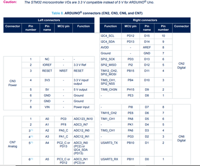

There is actually some issue while trying to configure the peripherals on the disco board.
Be it USART or SPI even after selecting the core for a particular communication protocol on board i am unable to get an response over it. Earlier i was trying to configure SPI and read a external SD CARD over SPI but am unable to get an response over SPI.
I even checked pins over oscilloscope and had not clock or data over MISO or MOSI.
As mentioned at below pins.

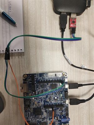

Then i tried sending data over USART3 pins and had no response there either.
Green is Tx connected to Pin D0 which is Rx on STM board
Blue is Rx connected to Pin D1 which is Tx on STM board
And Orange is GND.
I know HW connections are right, provided for reference.

I tried for both cores simultaneously M7 and M4. But received no response.
Is there a specific configuration which needs to be done to initiate the pins as required peripherals which i am missing?
2 REPLIES 2
mƎALLEm
Not clear what the problem is and I don't see any code related to SPI. Are you testing in debug mode? if yes that's tricky in Dual core. Are you really using both cores at the same time in your example?
Start by toggling a LED first then move on to SPI/UART communication.
mehrotraAkshay
Thanks for Replying.
Yes I am testing debug mode, and yes i am using both cores in my example. Earlier I had toggled LED 1 on M7 core and LED 2 on M4 core in parallel and it was working.
Issue us that i am getting no response on UART or SPI pin of ARDUINO connectors given on board.
Mentioned below for your reference.
