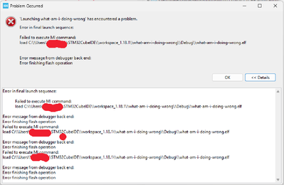

I've been beating my head for a while trying to use OpenOCD to download my program to the chip, and I'm getting error messages which cite a write algorithm error (errors attached below). I'm not really too sure what I'm doing wrong, and would greatly appreciate any help and insight with resolving this!
TL;DR. I'm getting errors like
Error: flash write algorithm aborted by target
Error: error executing stm32l4 flash write algorithm
Error: flash write failed = 00000088
Error: block write failed
Error: error writing to flash at address 0x08000000 at offset 0x00000000
in the Console log from OpenOCD.
I've reproduced the error using OpenOCD with STM32CubeIDE as follows where I set up a fresh project, demonstrate that using ST-LINK (ST-LINK GDB SERVER) works, and finally demonstrate that using OpenOCD fails.

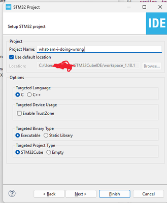

I create a new project with
File > New > STM32 Project
And go to "Board Selector", then select the "Commercial Part Number" to NUCLEO-U575ZI-Q.
I press "Next >", then fill out the following settings and press "Finish"

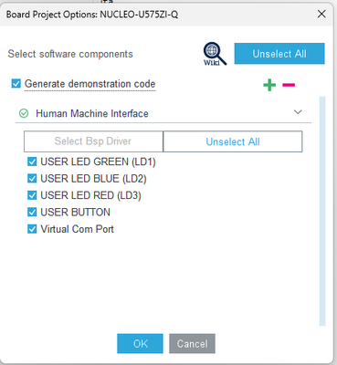

Not sure why the following menu popped up, but I filled it out as follows and pressed "Ok"

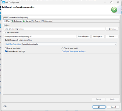

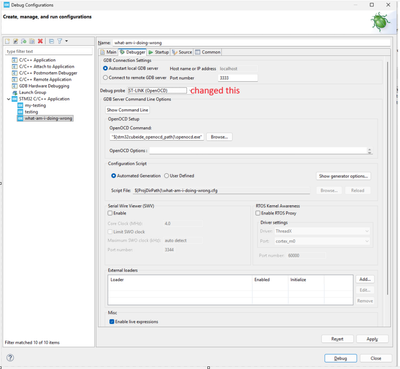

However, if I go to
Run>Debug Configurations...
Then, click the "Debugger" and change the "Debug probe" to "ST-LINK (OpenOCD)" as follows
and press "Apply" then "Close"; and finally press
I get the following error menu
And the "Console" shows

Info : Padding image section 0 at 0x08006d4b with 1 bytes

So, it looks like using the Debug probe as ST-LINK (ST-LINK GDB SERVER) works (I believe this shows my hardware connection is fine), but using ST-LINK (OpenOCD) doesn't work.

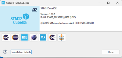

I'm running STM32CubeIDE version 1.19.0 ( Help > About STM32CubeIDE)

Hello @lindt ,
I reproduced your request, and the Debug of the project is finished successfully with ST-LINK (ST-LINK GDB SERVER) and with ST-LINK (OpenOCD).
I suggest that you erase the Full chip with CubeProgrammer and then run the Debug.
I will be waiting for your feedback.

Hey Mahmoud!
Really appreciate the reply again :)

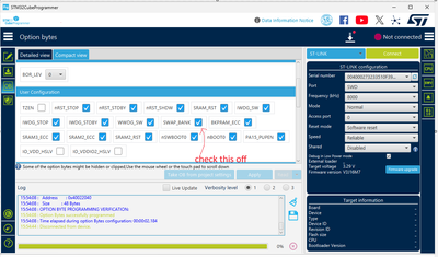

Thank you very much for the suggestion -- I think I've isolated the issue.now. It seems to me that flashing with OpenOCD when the SWAP_BANK option bit is enabled does not work (but flashing does indeed succeed as you suggest when it is disabled e.g., in the factory reset settings).
To reproduce it on your end, would it be please possible to try the aforementioned steps with the SWAP_BANK option bit enabled?
For example, we can use STM32CubeProgrammer to check off the SWAP_BANK option byte and press "Apply" (of course, only when the chip is connected [green button on the right])
Then, with the SWAP_BANK option bit enabled, running the commands in the original post should error as suggested
For completeness, the option bytes for STM32CubeProgrammer that I'm using are as follows (exported from the drop down menu beside the blue button "Read")

Hello @lindt ,
It is good to hear that your issue is fixed by disabling the Option Byte: SWAP_BANK through STM32CubeProgrammer.
In fact, OpenOCD does not support yet bank-swapped Flash remapping.
For more information, you can refer to the OpenOCD User’s Guide  section 12.5.1 External Flash.
Thanks.
