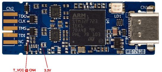

I have the STLink V3MINIE. When connected to the PC the red power LED is on. But I can't program any device because there is not target voltage.
ST Prog (v2.17) shows Target voltage 0.00 V
How can I fix this? Is there a jumper or solder connection missing on the stlink? Or is the board damaged?

I have connected the stlink to a custom board, was not aware, that the MINIE does not give out a voltage.
If I power my PCB externaly it works and the voltage is displayed :)
What is the suggested way to program a STM32 that has no external power only with a  STLINK?
I found a pin that has the needed 3.3V on the MINIE board. Would it be save to connect these 2 pads if current consumption of my PCB is low?
Is there a schematic availible for the MINIE board?
Thanks!

There is a way to power the board when in normal use. But how do people usually power the STM32 for programming in production? Or do I need to build a custom board using the STLINK-V3MODS?
It really would be nice to have a (solder) jumper on the STLINK boards to send power to the T_VCC pin.
Feed power via your programming jig / fixture / connector.
But the purpose of that pin is to sense the Target voltage - not to supply power.
It's an input to the ST-Link.
This is commonly used to identify when a target is present .
For low quantities, generally people will power it normally, attach the debugger and program.
For large quantities, you can either have the supplier program the chip before it gets to you, or you can create a fixture which provides power and programming pins. One can also use a custom programming header which provides these things.
The convention of not providing power from the programmer is common since the programmer may be running at a different voltage. Just something you have to know. The 10-pin header pinout is specified by ARM and ST is simply following the standard here.
