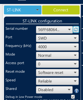

I have no idea why it happens but then I read that if my flasher is not original/STM32 blessed then it won't work. So I I bough STM32 official programmer: STLINK-V3MINIE,STLINK-V3. Here I simply get "cannot connect to target".

Primary try change mode Connect mode: Normal to Connect under reset.
Secondary MCU flash can be read protect = first step to use then is remove read protect = erase mcu flash.

In  ST-Link settings, reduce the SWD clock frequency to about 1 MHz and see if it helps.

try with your old st-linkV2 again, settings: normal , software reset:
Just power your H7 board from the st-link, connect: swd, swc, 5V, GND .
(connect these 4 wires first, then plug the st-link to the usb !)
Then connect...
Thanks, the flash erase halped and now I flash the board with both ST-LINK and UART.
