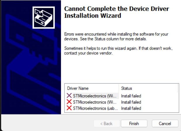

I have been trying various methods of installing the ST-Link USB drivers on my Windows 11 Laptop, with absolutely no success. Here is the output I see when I try to run the installation batch file from the stsw-link009 download:
When I plug in my nucleo board, this is what I see in the device manager:
When I open the properties on the ST-Link device, it (obviously) says that the drivers are not installed. Needless to say, if I try to run a program form the Cube IDE, I get a "No-ST-Link Detected" message. Also, if I open a project on the mbed IDE while the nucleo is plugged in, the board does get recognized. The board is the F091RC, although I am not sure that's relevant to my issues. The pre-loaded blinky program does work as well.
I am a beginner in this space, so please let me know if I'm doing something dumb. I've read and watched a lot of things to try and figure out, and everything I've found either completely skips over any issues with this (so presumably it isn't a normal issue) or they dive into writing custom INF, disabling Secure Boot, or other relatively extreme measures.

From the download page:
https://www.st.com/en/development-tools/stsw-link009.html
2022-02-28 2:10 AM
And now.... for Windows11 ?
2022-02-28 2:27 AM
I don't have the information.
Just anwering why it might not work on W11.
I have personnaly never tried. Maybe there is a compatibility mode.
From what I see, the ecosystem is stamped Win10 max so far.
2022-02-28 6:29 AM
Advise already given in this forum quite long ago (besides of modification and signing the INF) was to manually install the in-box winusb driver for ST-Link in the Device manager. This maybe works for early adopters of Win11 but there's time for ST to recognize Win11 .
2022-02-28 1:27 PM
Thanks for the input. I had seen that some forum posters had gotten it to work on 11, but I couldn't achieve the same success. I guess I'll just hold out until driver support is updated for Win11! Fingers crossed for it to be soon!
