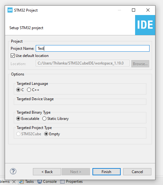

HI
i installed  STM32Cube IDE  latest version(1.19.0) in windows 10 platform for testing purpose, i got a problem that when i create a new project it cant select "STM32Cube" type (this is in gray mode), we tried with STM32F103C8T6 and some other chips , how to solve this , is it a bug in the ide ? , only we can create empty projects. please help me on this trouble , i have seen some solutions but it was not worked for me.

cs14
I have the same issue.  I have v1.19.0 and even tried uninstall/reinstall using latest version of software from website this morning (22/07/2025).  This was a problem with v1.18.1 and v1.19.0 was supposed to have fixed this - but it's cropped up again.  Any advice/help gratefully received as I'm currently stuck and unable to make any progress.

Thsl
yes , i already installed the CubeMx and checked but the problem still there , there is no any workable solutions found in the forum as well , is it a software bug ?
Yes, it is a known issue - see the pinned post:
STM32CubeIDE STM32Cube project creation issue
Thanks :thumbs_up:
Thsl
hi ,
I resolved the issue by uninstalling STM32CubeIDE version 1.19 and reinstalling version 1.18. After doing so, the option to select "STM32Cube" as the project type became available again, and the issue was resolved.
