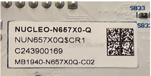

Hi @HANITALY
All seems to be correct in the last pictures you shared.
Could you confirm the backside stickers of the board?
Best regards,
Romain,
@RomainR.
Yes, of course.
You can find it in the attached picture.
Best Regards
Han
@HANITALY
Thank you for the picture, I used the same CR4 versions to program your signed binaries.
Your hardware seems to be correct for me.

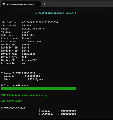

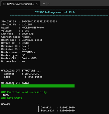

Let's check OTP11 and OTP124 configuration of your Nucleo board.
  1. Set STM32N6 in DEV_BOOT.
  2. Run these commands in a cmd terminal:
    STM32_Programmer_CLI.exe -c port=SWD ap=1 -otp displ word=11
    STM32_Programmer_CLI.exe -c port=SWD ap=1 -otp displ word=128
  3. Compare the values with mines in the capture bellow:
    OTP11: BOOTROM_CONFIG2 here default configuration is is serial NOR on XSPI.
OTP124: HCONF1 here the Bit 15 HSLV_VDDIO3 and Bit 16 HSLV_VDDIO2 are set
In the last solution you can follow this Knowledge Base article to flash OTP124  0x0001 8000:
https://community.st.com/t5/stm32-mcus/how-to-program-the-otp-fuse-bits-in-the-stm32n6/ta-p/782353
