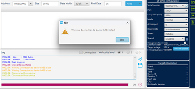

I am trying to start a debugger session to my new NUCLEO-N657X0-Q and getting the following error:
STMicroelectronics ST-LINK GDB server. Version 7.9.0
Copyright (c) 2024, STMicroelectronics. All rights reserved.
Starting server with the following options:
Persistent Mode : Disabled
Logging Level : 1
Listen Port Number : 61234
Status Refresh Delay : 15s
Verbose Mode : Disabled
SWD Debug : Enabled
InitWhile : Enabled
Target unknown error 32
Error in initializing ST-LINK device.
Reason: Unknown. Please check power and cabling to target.
 I am using the latest version of STM32CubeIDE (1.17.0)
The STM32CubeProgrammer (v2.18.0) is also unable to program any binaries on the board.  After changing the Reset Mode to "Hardware reset" I am able to connect to the board, but immediately get the error message:
15:09:28:207 : UR connection mode is defined with the HWrst reset mode
15:09:28:364 : ST-LINK SN : 002F00453433511830343835
15:09:28:365 : ST-LINK FW : V3J15M7
15:09:28:365 : Board : NUCLEO-N657X0-Q
15:09:28:365 : Voltage : 3.27V
15:09:28:365 : SWD freq : 8000 KHz
15:09:28:365 : Connect mode: Normal
15:09:28:365 : Reset mode : Hardware reset
15:09:28:365 : Device ID : 0x486
15:09:28:365 : Revision ID : Rev A
15:09:28:365 : reset ap 1
15:09:28:365 : Reading data...
15:09:28:365 : r ap 1 @0x00000000 0x00000004 bytes Data 0x00000018
15:09:28:365 : Database: Config 0 is active.
15:09:28:461 : UPLOADING ...
15:09:28:461 : Size : 1024 Bytes
15:09:28:461 : Address : 0x8000000
15:09:28:462 : Read progress:
15:09:28:462 : Reading data...
15:09:28:462 : r ap 1 @0x08000000 0x00000400 bytes Data 0x00000018
15:09:28:541 : r ap 1 @0x08000000 0x00000400 bytes Data 0x00000011
15:09:28:541 : Error: Data read failed
 Unfortunately link to user manual UM3417, which is https://www.st.com/resource/en/user_manual/dm01122391.pdf (per STM32 Nucleo-144 boards data brief) is currently unavailable.
I don't understand what I am doing wrong from the error messages, and can't access the user manual.  I would appreciate if someone can shed light on the issue I am seeing.
