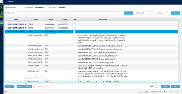

Thanks for your detail description about OTP operation. On our own PCBA , we use STM32N657L0. Now I try to modfiy OTP19 to config PA8 as BOOT1 pin , becasuse PA6 (default pin) used as SPI6_MISO,I use STM32cubeProgrammer to operate OTP19.
According to spec as below: i calculate OPT19   0x1020 0000
Bit Field (Bits) Name Value Remarks
[17: 0]Reserved All reserved bits must be written as 0
[20:18]mg_hicr_value0You did not specify a value. Using the default "others", meaning "RNG HTCR not modified".
[24:21]dev_boot_port11 corresponds to PA (Bank A).
[28:25]dev_boot_pin8For GPIOA, Pin ID 8 directly corresponds to the numerical value 8.
[31:29] Reserved0All reserved bits must be written as 0
but i read OTP19 via STM32cubeProgrammer after configuring OPT19 to 0x10200000, the field dev_boot_pin is still 0 (display). anything wrong ?
September 17, 2026
We were also facing the slimier issue when try to chnage the boot1 pin to PN10
