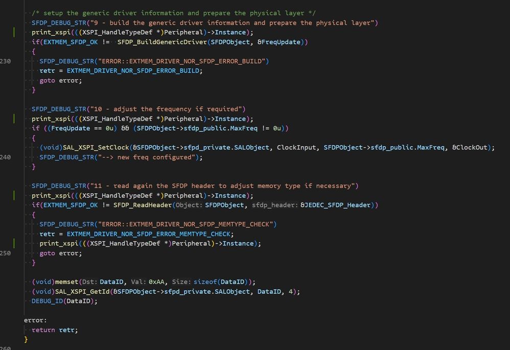

Could you please enable the EXTMEM SALXSPI logging by adding the line #define EXTMEM_SAL_XSPI_DEBUG_LEVEL 2 to the stm32_extmem_conf.h file ?
Additionally, please dump the XSPI configuration registers between steps 9, 10, and 11 for further investigation.

I have added the EXTMEMSALXSPIDEBUGLEVEL macro and printed the registers for XSPI2 in steps 9, 10 and 11
The location of the print is shown below.
The log as follow:

Hello @totoro ,
Thanks for the dump of registers!
On the second reading of the SFDP signature (step 11), we can see that the memory has been configured in 1S8S8S mode.
By checking the XSPI register, we found the following:
  • IR => 0x5A (Read SFDP command)
  • AR => 0x0 (Address)
  • CCR => 0x04003401
    • DMODE = 1 => Data on one line
    • ADSIZE = 3 => 32-bit address
    • ADMODE = 4 => Address on eight lines
    • ISIZE = 0 => 8-bit instruction
    • IMODE = 1 => Instruction on one line
  • DTR is disabled for Instruction, Address, and Data
  • TCR = 8 => 8 dummy cycles
According to the memory datasheet, the READ SFDP command is only described for standard SPI and octal DDR modes.
Could you try modifying the following line in the function
SAL_XSPI_GetSFDP(SAL_XSPI_ObjectTypeDef *SalXspi, uint32_t Address, uint8_t *Data, uint32_t DataSize)
if (s_command.AddressMode == HAL_XSPI_ADDRESS_1_LINE)
to
  if ((s_command.AddressMode == HAL_XSPI_ADDRESS_1_LINE) || (s_command.AddressMode == HAL_XSPI_ADDRESS_8_LINES))
Kind regards,

        SFDP::11 - read again the SFDP header to adjust memory type if necessary
                XSPI Configuration start
                XSPI Instance: 0x5200a000
                CR     = 0x00000001
                DCR1   = 0x01190300
                DCR2   = 0x00000002
                DCR3   = 0x00000000
                DCR4   = 0x00000000
                SR     = 0x00000004
                FCR    = 0x00000000
                DLR    = 0x00000017
                AR     = 0x000000E8
                DR     = 0x00000000
                PSMKR  = 0x00000000
                PSMAR  = 0x00000000
                PIR    = 0x00000000
                CCR    = 0x00000001
                TCR    = 0x10000000
                IR     = 0x000000B7
                ABR    = 0x00000000
                LPTR   = 0x00000000
                WPCCR  = 0x00000000
                WPTCR  = 0x00000000
                WPIR   = 0x00000000
                WPABR  = 0x00000000
                WCCR   = 0x00000000
                WTCR   = 0x00000000
                WIR    = 0x00000000
                WABR   = 0x00000000
                HLCR   = 0x00000000
                CALFCR = 0x00120047
                CALMR  = 0x00000000
                CALSOR = 0x00120011
                CALSIR = 0x00120011
                XSPI Configuration end
                SFDP::SFDP_ReadHeader
                SFDP::SFDP signature::0x0
                SFDP::signature of the header: KO
        SFDP::ERROR::EXTMEM_DRIVER_NOR_SFDP_MEMTYPE_CHECK

Could you please comment out the second reading of the SFDP signature in the EMM driver, as well as the second reading of the ID ?
Kind regards
Comment out the second reading of the SFDP signature and the ID in the EMM driver, still can't jump to the app.

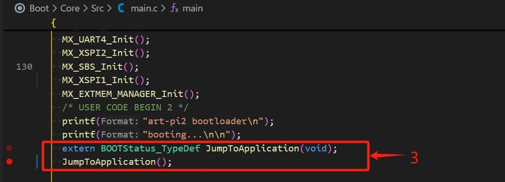

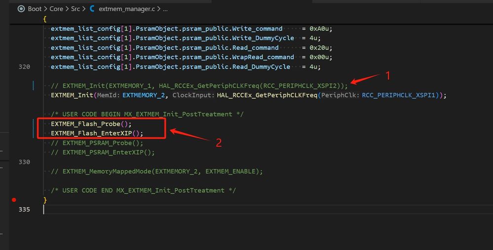

I transplanted this flash program from somewhere else, into mapping mode.
There are several modifications.
Read Flash ID success:0xef 0x5b 0x1a
Reconfigure Flash clock
Flash Re-Enter Octal DTR and Read ID success:ef 1a 00
Flash XIP success
art-pi2 bootloader
booting...
EXTMEM_GetMapAddress
[info application]Hello main!
Although it is available now, I would like to figure out if there is a bug in the middleware of the STM32_ExtMem_Manager.
The attachment is the whole project.
