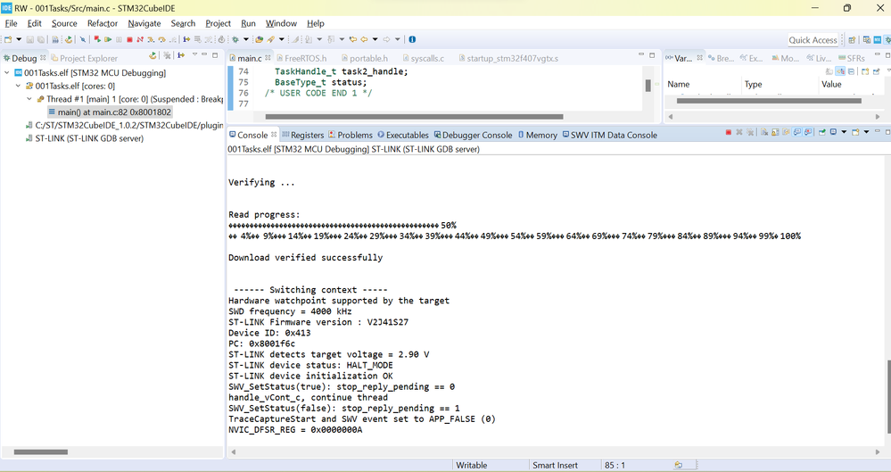

Not able to debug with STM32F07 dev board. Attached the debug log, kindly help me in this. Thank

And what? Maybe you use pins in code = debug not possible or voltage unstable
ST-LINK detects target voltage = 2.90 V
ST-LINK device status: HALT_MODE
‎2023-03-11 8:26 AM
Which board and chip specifically?
Is it a low pin count device?
Can you connect under reset? Is NRST physically connected in your design?
Can you connect or adjust BOOT0 pin or settings?
Does your code interfere with the SWD pin configuration? Disable it, or go into a low power mode?
Problems are hard to troubleshoot without context to work from. Elaborate
‎2023-04-01 1:51 AM
Board : STM32F407VG MCU * New order code STM32F407G-DISC1
I am trying to integrate freeRTOS and run a sample program using SWD pin. I am getting the below error and log(partial)

‎2023-04-01 6:24 AM
For what you need SWV. ?
‎2023-04-04 5:47 AM
Sorry, it is not SWV. Confiured SWO pin for supportinng printf style debugging
‎2023-04-04 6:35 AM
Hello @SNaga.6​ ?
Could you, please, attach a screenshot of the debug configuration.
Thanks,
Rim
‎2023-04-04 9:23 AM
Check SB12 for SWO/PB3 operation
