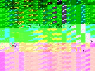

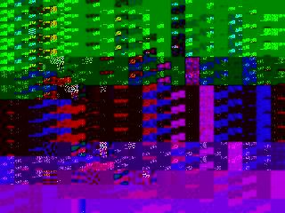

fisy
Hi @pikud
Were you able to solve your problems with the corrupted jpegs?
I have been trying to write images to my sd card via FileX based on these examples:
https://github.com/STMicroelectronics/STM32CubeN6/tree/main/Projects/STM32N6570-DK/Examples/JPEG/JPEG_EncodingFromOSPI_DMA
and https://github.com/STMicroelectronics/STM32CubeH7/tree/master/Projects/STM32H743I-EVAL/Examples/JPEG/JPEG_EncodingUsingFs_DMA
I have tried all possible combinations. My current approach is based on the second example, where the encode_dma was adapted to write to the file directly instead of going via a buffer.
In the end no matter what I try, i get images that look like this:
Sometimes also only the upper part of the image contains colored chunks and the rest is grey.

The images above show the output when using the examples "Image_rgb_565.c" but before i was using data from IMX335 with similar output results. The same happens when using the approach seen in the STM32N6 example.
Has anyone seen similar results from the JPEG peripheral?
