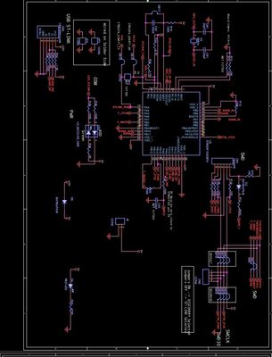

I made a custom board keeping stm32f429 disc1 board as a reference.
When I connect the the board through usb mini it's showing USB not recognised. Below is my stlink schematic.
15 REPLIES 15
Well if that is the case You have to replace only chip from st-link part of the board.
Sorry for asking it again will my custom board work if I replace STM32F103 chip from my old discovery board and put it into my board what are the precautionary measure before replacing.
Or should I develop fully working code in my disc1 board and replace both chip into my board.
I would replace only f103 (programmed chip from st-link), and this board should be able to program via cubeprogrammer or cubeide.
If you only replace the STM32F103, it will work. You do not need to change the STM32F4xx chip.
(Provided your board is equivalent to the discovery board.)
You can try to program the new STM32F103 to a "selfmade st-link" , see :
https://hackaday.io/project/179054-custom-st-link-v20-v21-v30
Thank you my board started working like disc1 after replacing STM32F103.
