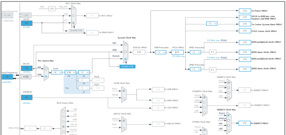

I initially began with a blank template using an internal clock, and the code ran without any problems. However, when I attempted to configure a 24MHz external oscillator, I encountered an error loop during debugging. Here's the sequence of events:
  1. Started with a blank template using an internal clock - Code ran as expected without any issues.
  2. Configured the clock tree to use a 24MHz external oscillator, set the main clock rate to 170MHz, and allowed the clock tree to resolve the rest.
  3. Compiled and uploaded the code again, but it failed to progress beyond the SystemClock_Config stage.
Upon investigating further, I discovered that the HSE ready bit is not set in time for some reason during the clock configuration. As a result, HAL_RCC_OscConfig() returned HAL_TIMEOUT, leading the program into an error loop. I tried Increasing the timeout value from 100 to 1000 but it didn't help.

My clock tree is shown below:

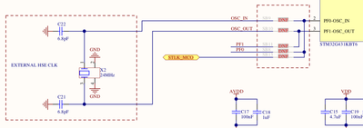

Hi @STOne-32
Thank you for your quick response. I've located the G431 NUCLEO board schematic here:
https://www.st.com/resource/en/schematic_pack/mb1430-g431kbt6-a02_schematic_internal.pdf

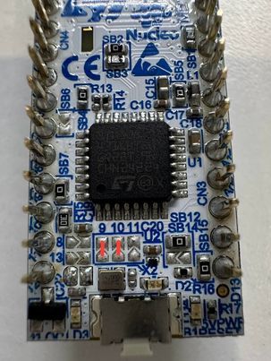

Upon reviewing the schematic, I observed that the clock signal can be selected between the STLink Master Clock Output (MCO) and the 24MHz external oscillator by configuring soldering bridges (shown in the screenshot below). The issue with the previous clock error stemmed from none of the soldering bridges being connected on the new development board, leading to no clock signal being fed into the HSE pin.
To address this, I plan to connect the SB9 and SB10 soldering bridges on the development board, as illustrated below:
Your guidance has been immensely helpful in identifying the root cause of the problem. I appreciate your support.

Dear @xlin.1
Can you provide the schematics and how the 24MHz crystal or 24MHz oscillator is connected to the HSE pins ?
Have a good day,
STOne-32
Hi @STOne-32
