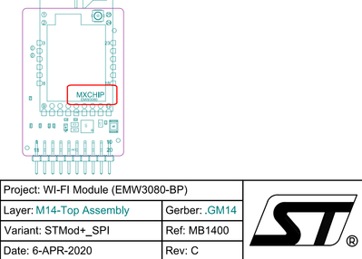

https://www.st.com/content/ccc/resource/technical/layouts_and_diagrams/schematic_pack/group2/51/f0/39/da/60/2a/40/60/mb1400-stmodplus-spi-c01-schematic/files/mb1400-stmodplus-spi-c01-schematic.pdf/jcr:content/translations/en.mb1400-stmodplus-spi-c01-schematic.pdf

That's just a schematic - don't you have a link to ST's Product Page for that board?

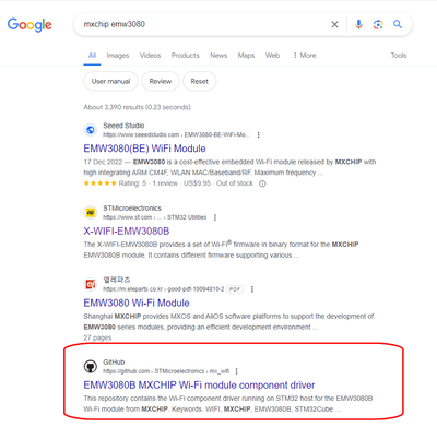

OK, so that schematic has this in it:
A quick google for that part number gives:
https://github.com/STMicroelectronics/mx_wifi
