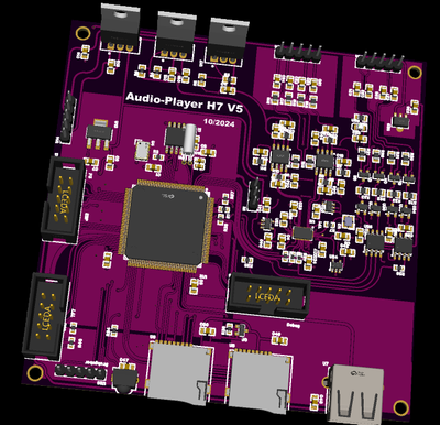

so i have a strange problem with SDMMC and USB msc :
- custom board with H743ZI , 2x sd-card , 1x USB msc , for USB stick data;
- software using HAL, FatFS etc; made on IDE 1.10 , migrate ...13, 15, 17, 18, now 1.18.1 (actual)
- program working fine since > 1 year , but without DMA on sdmmc and usb/host ;
- for debug/messages with SWO, SWV working , as it should;
Now i tried using the DMA setting for sd and usb - no, nothing working.
SD stays on waiting for first data transfer, USB hangs in a loop: connecting-disconnected-connecting....

I have no idea what to say because you didn't suggest any "custom-board" schematic
and any sourcecode of the project....

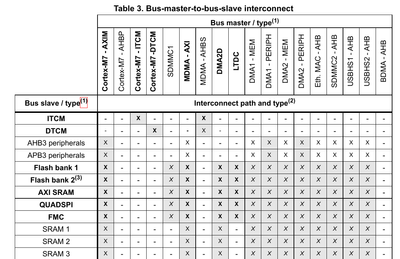

But other problem i found : (my error) can the DMA reach the memory at all?
So looking at H7  bus matrix   :
This might explain, why dma on sdmmc2 working, but not on sdmmc1, depending on the RAM, its using. (or i gave it...) So this is more or less clear now.
