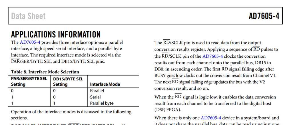

There is Applications Information in the Datasheet - the interfaces are described there:
https://www.analog.com/media/en/technical-documentation/data-sheets/AD7605-4.pdf#page=23
You need to study those sections - they define what you need to implement in the host microcontroller.
The AD7605 neither knows nor cares what microcontroller you use - it just has to follow those specifications.
