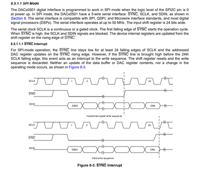

I'm trying to do 3-WIRE SPI communication with DAC60501,
but no matter what I do, the output value doesn't change.
I checked the waveform with a scope and it all was OK.

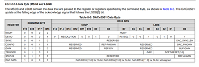

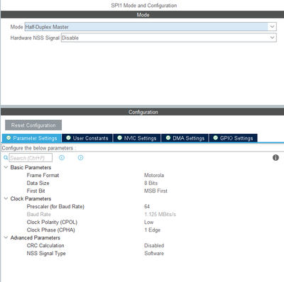

The first falling edge of SYNC starts the operation cycle --> CPHA= 1 Edge
uint8_t aTxBuffer[3] = { 0x08, 0x7F, 0xAA };  --> command = DAC_DATA, value = 0x7FA (12bit)
I set up CUBE MX as above.

Just one remark:
the 60501 is a 12bit DAC
Your 0x7AA are more than that.
12Bit (left allgin)  is max 0x7FB0 the right 4 bit should
be 0.
Try  0x3FB0 as value....

bmckenney
I haven't used CubeMX, but over here it's said that "N Edge" means "Captured on the Nth edge".
For CPOL=0 (low) the "falling edge" is the second, so I think you want "2 Edge" here.
[There have been times when, unable to decode an inscrutable data sheet, I just tried all the SPI modes (there are only 4) to see which one "worked".]
