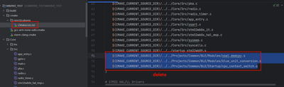

Description: I am experiencing a linker failure when building a project generated with STM32CubeMX using the CMake toolchain option. While the project compiles and links correctly when using the standard STM32CubeIDE (Eclipse-based) workflow, the CMake-based build in VS Code fails during the linking stage.
The linker reports multiple definitions for several symbols located in the BLE Middleware assembly files. It appears that the same source files are being compiled into different targets and then linked together, causing collisions.

Observations: The build log shows that files like osal_memcpy.s, blue_unit_conversion.s, and cpu_context_switch.s are being compiled twice:
Once as part of the main project target (CMakeFiles/ble_test.dir/...).
Once as part of the Common target within the auto-generated CubeMX CMake directory (cmake/stm32cubemx/CMakeFiles/Common.dir/...).

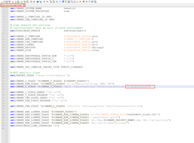

Additionally, I am seeing a dangerous relocation: unsupported relocation error in system_stm32wb0x.c during SystemInit, which is likely a side effect of the inconsistent object linking caused by the duplicated assembly symbols.
Request: Is this a known bug in the CubeMX v6.16.1 CMake template for the WB series? Are there any recommended adjustments to the CMakeLists.txt or the .ioc configuration to prevent the generator from creating these redundant source entries?
Hello @rlopes @vrxiaojie
Issue is fixed in the latest STM32CubeMX release 6.17.0.
You can get it through this link.
Thanks

I reproduced your behavior using STM32CubeMX 6.16.1 and GNU 13.3.but I did not get dangerous relocation error.
Could you please reproduce the test with GNU 13.3.1, knowing that you should add this flag on -z noexecstack on gcc-arm-none-eabi.cmake.
To further the investigation, I also need the compilation console.

vrxiaojie
I found a temporary solution to avoid this error.
in cmake/stm32cubemx/CmakeLists.txt, delete these.
However I have to delete these again after code generation from CubeMX.
