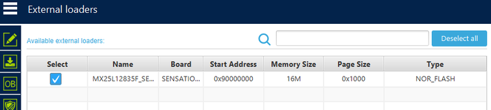

After I change the linker file with linker.ld of the branch contrib stm32-external-loader\Loader_Files\other devices and build and generate the file .stldr and put it into STM32CubeProgrammer\bin\ExternalLoader
Then when I open STM32CubeProgrammer I see my external loader in the list :

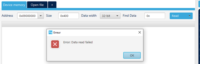

But when I try to read or erase at QSPI address 0x90000000 I get an error immediatly and nothing happens on the QSPI bus signals like if the functions are not executed :
Does anyone have an idea of what I forgot to do ?

The error in STM32Cube Programmer is the init function that fail directly:
15:03:20:870 : Read progress:
15:03:20:871 : Reading data...
15:03:20:871 : Init flashloader...
15:03:20:871 : Init function fail
15:03:20:876 : Error: Data read failed
I try to empty the Init function and only return 1 (=LOADER_OK) and have the same behavior.
