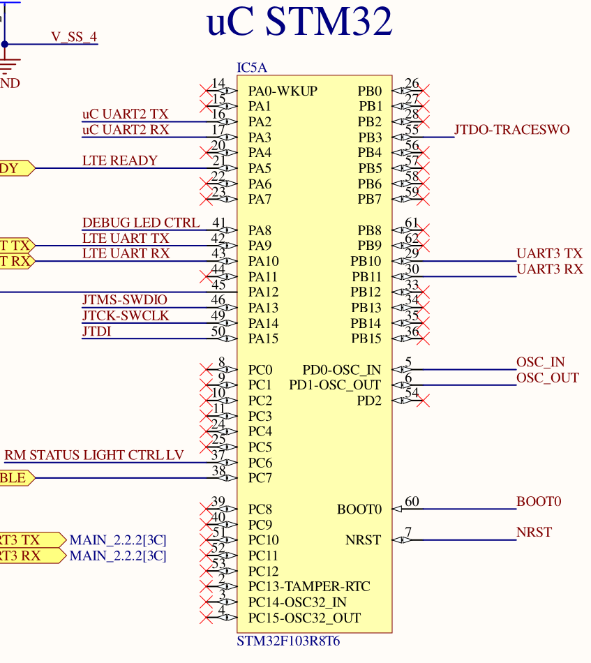

I have the following code trying to turn 5 pixels of the LED strip to red. The setup I have is the LED strip is connected to PC6.

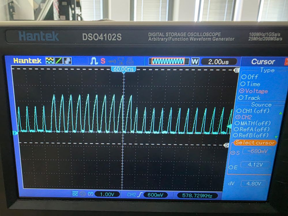

I already had the output hooked up to an oscilloscope and the output waves look correct. However, when I run this code, nothing changes on the LED strip. I just want to ask if there is something wrong with my code here, or could there be any potential hardware issues I did not think of.

Andrew Neil
Please show your schematic.
Please share scope screenshots - someone may be able to spot something...

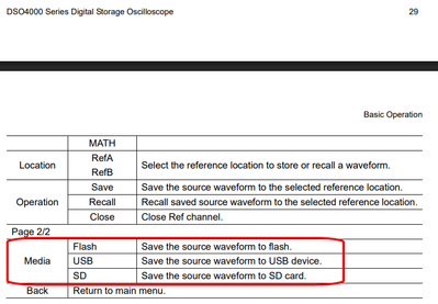

If your scope has a screenshot facility, please use it - this will be far better than trying to photograph the screen!
RM STATUS LIGHT CTRL LV is the LED strip.
The high spike is for bit 1 to be sent to the LED, and the low spike is for bit 0. The high spike is high for 0.75us and the low spike is high for 0.375us, these are according to the spec of WS2812B.

That doesn't show how the STM32 is actually connected to the LED strip, nor the LED power supply.

you missed:
Your scope does have that facility:

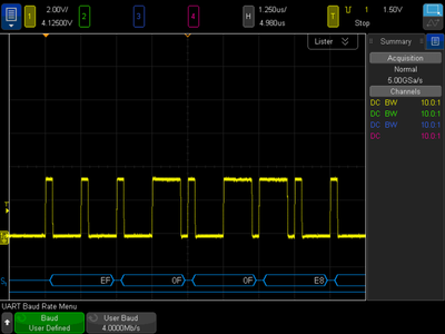

Anyhow, that waveform looks terrible: there should be clear pulses with clean edges, and consistent height; eg,
from: https://www.pjrc.com/2017/10/

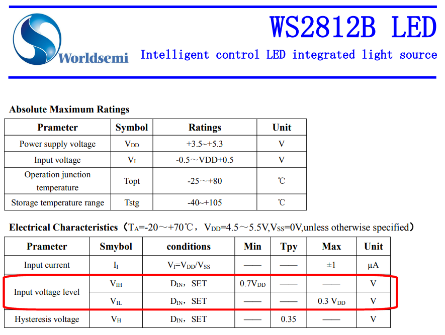

From the LED datasheet:
You haven't shown what your VDD is for the LEDs but, if it's 3.3V, that would mean that the minimum 'High' voltage is 2.3V.
In your scope trace, the short spikes aren't even reaching 2V, and even the tall ones are marginal.
Thank you for the comments, I checked again and I had the configuration for the GPIO wrong. I configured it to be open-drain while it should be push-pull instead. Changing to push-pull makes the edges cleaner and the LEDs now have the expected colors.
