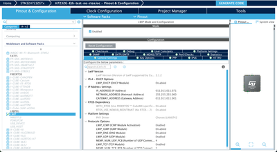

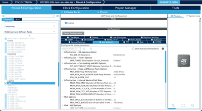

Config:
These config files are based from .ioc files from this thread: https://community.st.com/t5/stm32-mcus-embedded-software/h723-ethernet-lwip-ping-problem/m-p/758419#M58561  (No help from linked topic helped here)
I've also tried this tutorial with the same results: https://rafalbartoszak.com/stm32-ethernet-the-first-launch/

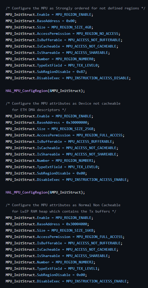

After reviewing your screenshots, I noticed several crucial configuration steps were missed for the Ethernet to work properly. Notably:
  • MPU configuration for Ethernet buffers and descriptors

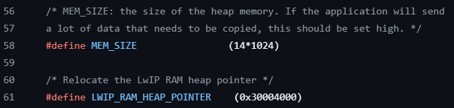

  • Insufficient LwIP MEM_SIZE
I suggest following the example project LwIP_TCP_Echo_ServerFor MPU configuration, enable both I-Cache and D-Cache, and apply the recommended settings.

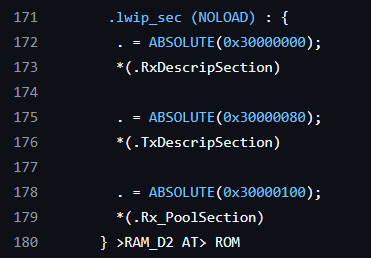

Additionally, add the following memory section declarations for Ethernet descriptors and buffers in the STM32H723ZGTX_FLASH.ld linker file to ensure proper placement and alignment with the MPU configuration.
Finally, increase the heap memory allocation by modifying the memory size definition inside lwipopts.h.
Please apply these changes and let me know how it goes.
