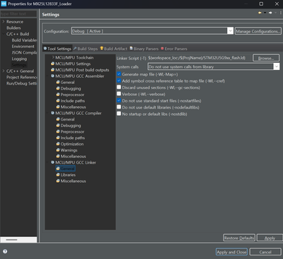

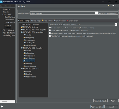

- **Linker Flags:** `-nostartfiles -static --specs=nano.specs`
- **Output Format:** .stldr (ELF format)
