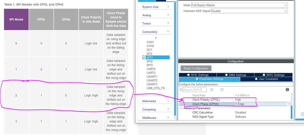

I'd like to setup SPI mode 2 in my project with cpol=1 and cpha=0. But in SPI setup for cpha options are 1 or 2 edges. Which option do I have to select?

Javier1
Principal
As @Community member​ said, "1 edge" reffers to 1st edge
0693W00000WKsL6QAL.pngsource

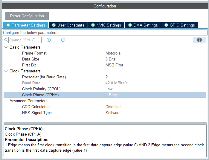

waclawek.jan
Still, what's "1st edge", exactly?
The traditional - and unambiguous - way to describe CPHA selection is "sample, then shift" vs. "shift, then sample".
CubeMX might've also made use of the fact that it's a visual tool, and might've added waveforms to clarify things.
Anywhere else CPHA is setup as 0/1 or high/low. Maybe 0 is 1st edge, and 1 is 2nd edge.
sample on 1st clock edge vs. on 2nd edge of clock.
Quite uncommon, but not wrong. And well explained in the IDE:
0693W00000WKw7cQAD.pnghth
