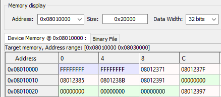

Since I updated the STM32CubeIDE to v1.8.0 each second flash process fails with Error: Data mismatch found at address. With the STM32CubeIDE v1.6.0 everything works fine.
In the project the start address of the flash area is set to 0x08010000 because on 0x08000000 the bootloader is located.

Error: Data mismatch found at address 0x08010000 (byte = 0xFF instead of 0x00)
Error: Download verification failed
Shutting down...
Exit.
The first 8 bytes were not programmed.
MCU: STM32G474
Programmer: ST-Link/V2
On an erased flash the flash process (triggered via STM32CubeIDE Run/Debug) is working. Afterwards each second flash process fails. Maybe the problem is located in the updated STM32CubeProgrammer. I have tried different debugger settings without success.
