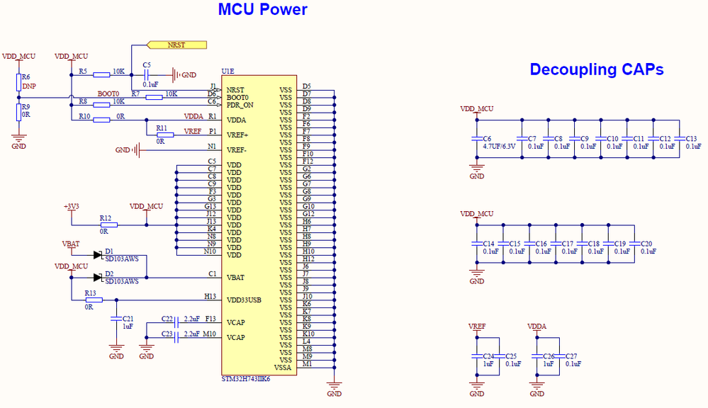

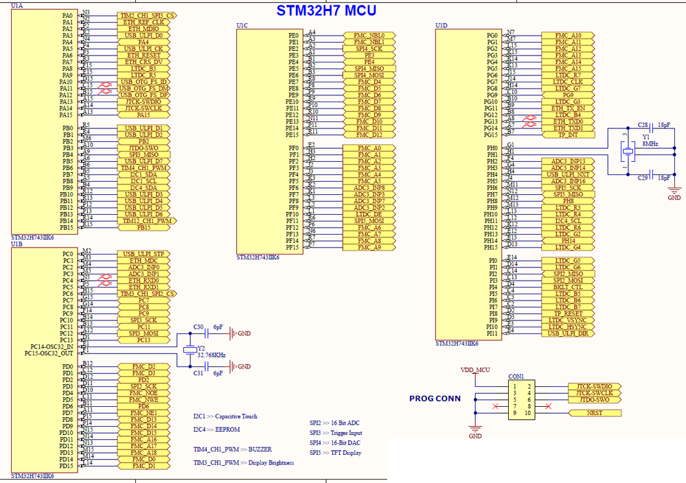

I am trying to flash a custom PCB having STM32H743IIK6 MCU using SWD interface.
I have tried below methods but all are Failing
  1. Flashing using 'STM32CubeProgrammer' using all 'Mode' and 'Reset Mode' options Failed
  2. Flashing using STM32CubeIDE tried using STLINK SWD and J-Link SWD Failed
  3. Flashing using STM32 ST-Link Utility Failed.
Below is the Schematic of the programming and power supply section of the MCU.
I have assembled 2 different boards and in all 2 boards, Most of times, I am getting 0V on VCAP pins. but sometimes this VCAP voltage fluctuate around 0.7V to 1.1V.
RPanc.1
Problem solved!
It was the issue of MCU BGA pad soldering.
1 REPLY 1
RPanc.1
Problem solved!
