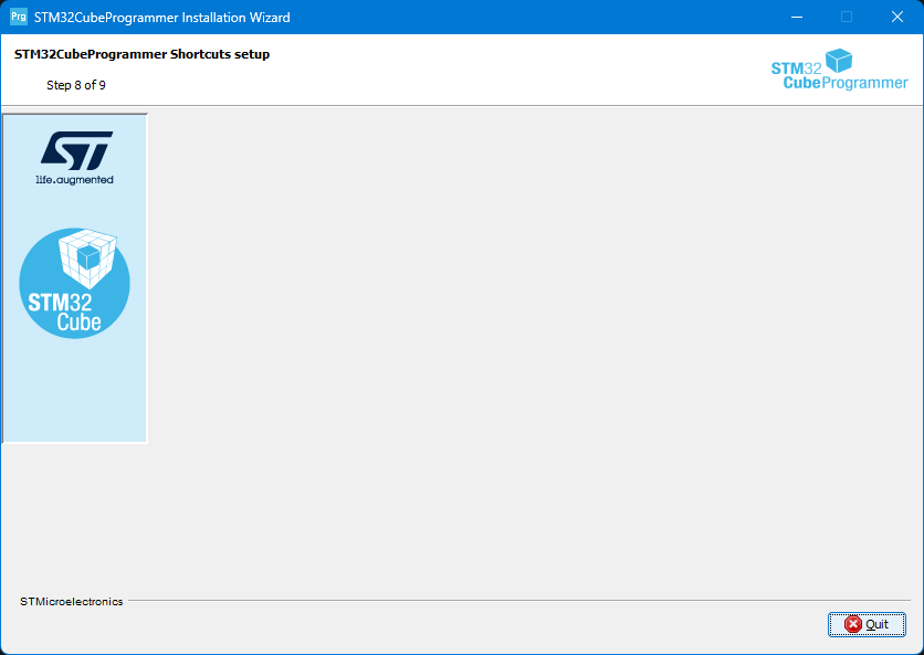

Stm32cubeprogrammer installation does not proceed to the final stage, it remains at step 8 and is not completed. I tried the program on three different PCs with administrator rights, the result is the same, the installation does not complete.

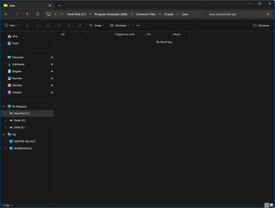

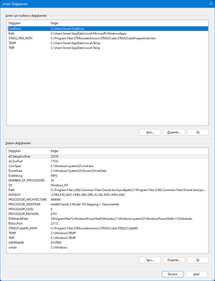

Hello @Aziz BRIGUI
This is the situation on the PC I use.
I tried installing Windows 10 and Windows 11 on two different PCs without installing any programs, the result did not change, it remains at step 8. I think it might be regional or Windows language related.
Soner23
Hello @Aziz BRIGUI
Let me share an update on the issue.
I tried to make a fresh installation with English (USA) Language Windows 11 and install the program, it was installed without any problems.
My computer's language is Turkish, I added an English language pack to this computer, then I tried the installation again and it was installed without any problems.
Turkish I cannot complete the installation with Windows 11 and Windows 10. I hope you can solve this problem as soon as possible.
Thank you very much, @Soner23 . I had the same problem and thanks to you I fixed it.
