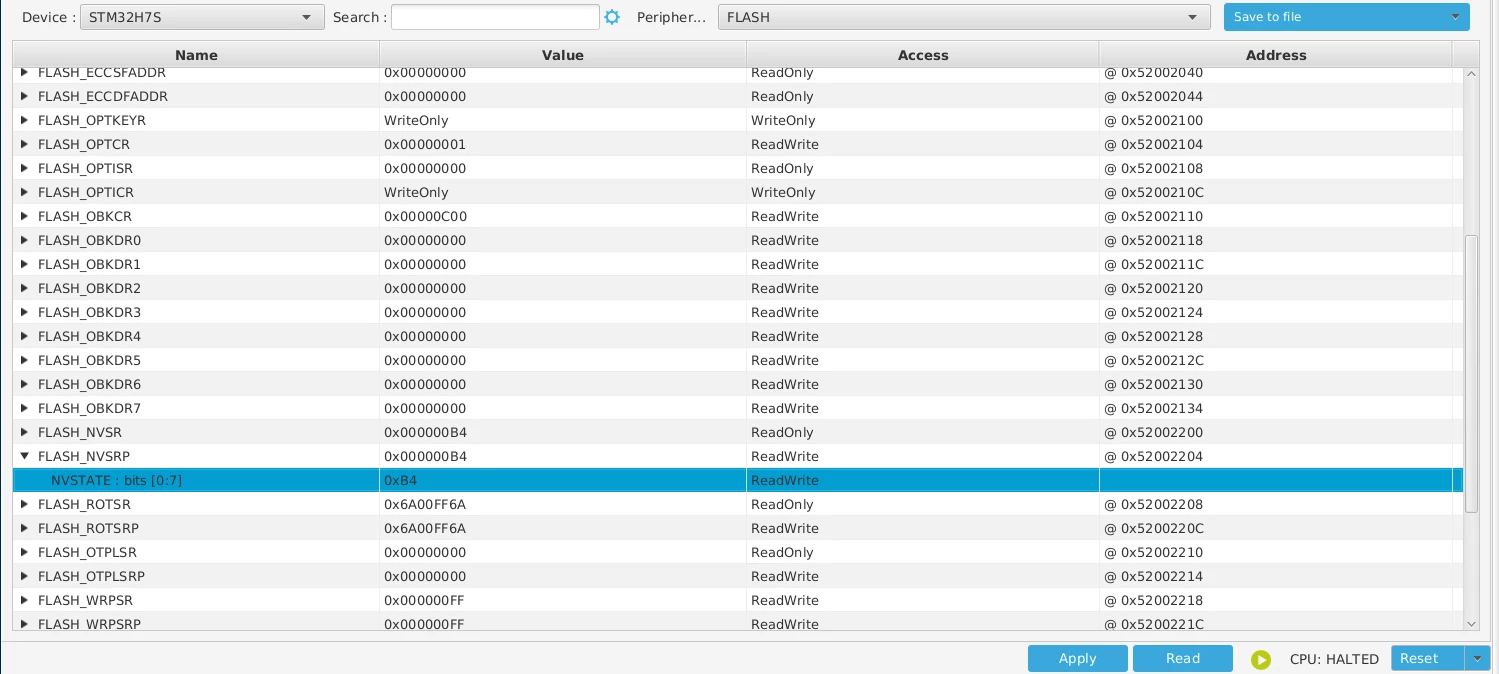

Best answer by neo-knight-td
Hi all,
I have checked the FLASH registers using STM32CubeProgrammer and the NVSTATE is programmed to 0xB4, which corresponds to OPENED according to the Reference Manual :
So the issue is not a wrong configuration of AP1, it is a wrong selection of the AP inside the IDE. I recreated a new blank project for the NUCLEO-H7S3L8 and confirmed the default access port is 0. Only after changing AP to 1 I was able to Debug the program.
A fix in STM32CubeIDE should be provided as it makes no sense to configure the debugger by default to a port which is closed.

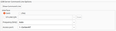

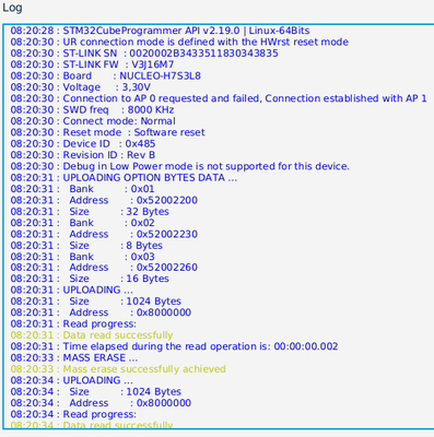

However, after performing an Xth reset with the STM32CubeProgrammer, I remarked something in the logs :
The AP0 seemed to be closed. I thus modified the AP into STM32CubeIDE Debugger Configuration :
After that, I was able to Debug the board.

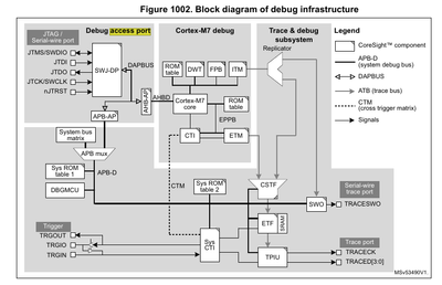

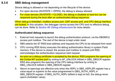

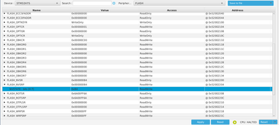

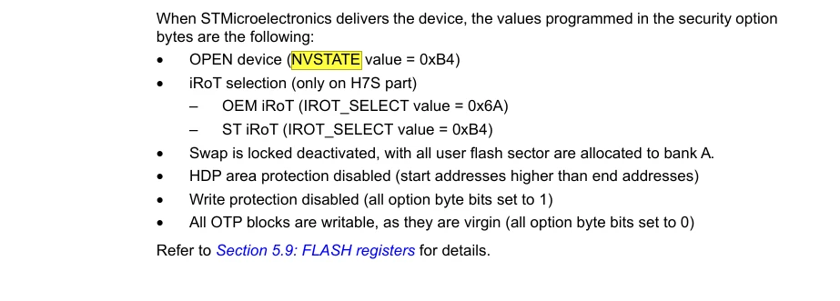

@KDJEM.1, do you have an idea why the AP used by default (AP0) in STM32CubeIDE Debugger is closed ?According to the Reference Manual (RM0477), there are two Debug APs : APB-AP (DBGMCU) and AHB-AP (Cortex M7) :
AHB-AP (Cortex M7) might be closed when debug is disabled (NVSTATE = CLOSE). It then needs to be opened via APB-AP :
Is the base project for NUCLEO-H7S3L8 configuring NVSTATE = CLOSE by default in the FLASH register ? Why is it the case ? If it is the case, why not adapting the default debugger configuration ?

neo-knight-tdAuthorBest answer
May 7, 2025
Hi all,
