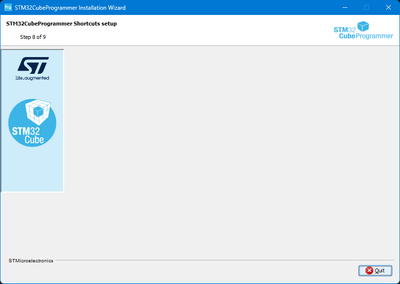

Stm32cubeprogrammer installation does not proceed to the final stage, it remains at step 8 and is not completed. I tried the program on three different PCs with administrator rights, the result is the same, the installation does not complete.

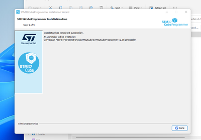

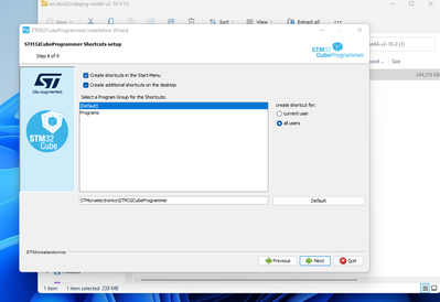

For now I am not able to reproduce on my side, below you'll find some relevant screenshots:
If you have any other detail on your setup, do not hesitate to share.

In your first image, I don't see the screen. In step 8, the screen appears blank.
I am at a loss here since I am still unable to reproduce. Maybe try removing any reference to Java in the environment variables ?
