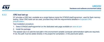

1.I am unable to found the CRC tool in STM32cube programmer which is given in UM3252. Where can i found the CRC tool?

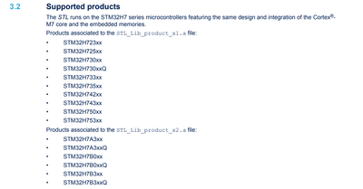

2.I have added and compiled successfully the SRC an INC to my project from given firmware ...Middleware\ST\STM32_Safety_STL. When i add linker file "STL_Lib_product_x1.a " to my project in MCU GCC Linker/Libraries in STM32cube IDE. Where ,which and how can i add the the object file located in LIB folder from ...Middleware\ST\STM32_Safety_STL?

1- You should download STM32CubeProgrammer. You can find it under this link STM32CubeProg - STM32CubeProgrammer software for all STM32 - STMicroelectronics. This step is described here
and the CLI to use is described here:
2- A way to do it in STM32CubeIDE should be through "Project properties>C/C++ build>Settings>Tool Settings>MCU GCC linker>Libraries>add". Make sure you add the correct library for your device following this recommendation:

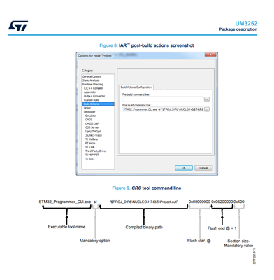

1.I have added Library part successfully by adding a prefix : to library file in the above said path. If i didn't prefix : then the CubeIDE gives the error Library cannot find.
2.I have downloaded STM32CubeProgrammer v2.19.0. I am unable to understand the "6.2.2 CRC tool set-up" given by you(above picture) in figure8 IAR post build actions screenshot relation to STM32cube IDE. Where can i found the above screen sheet i.e is it part of STM32cube IDE or it is in separate application?
3.
3.Please guide me step by step to do the flash test successfully using STM32cube IDE ,IAR Workbench and CRC tool.
‎2025-05-28 6:45 AM
Hello, for the post-build command for STM32CubeIDE projects, please refer to the included example project for STM32CubeIDE. You will find the post-build-command configuration in STM32CubeIDE in Project->Settings->C/C++ Build->Settings->Build Steps.
As explained in the "CRC tool set-up" chapter in the UM3252, it will only work if your OS $PATH variable contains the path to the STM32CubeProgrammer, or rather the directory containing the STM32_Programmer_CLI executable.
If that is not your case, you will need to change the command to explicitly call the STM32_Programmer_CLI executable by its full path (eg. /full/path/to/stm32cubeprogrammer/bin/STM32_Programmer_CLI.exe instead of just STM32_Programmer_CLI.exe.
There is also version of STM32_Programmer_CLI packaged within the STM32CubeIDE installation. You can call it by using the STM32CubeIDE's internal environment variable $cubeide_cubeprogrammer_path.
The simplified command to call the packaged executable would then e.g. be:
${cubeide_cubeprogrammer_path}/STM32_Programmer_CLI.exe -sl ${CWD}/${BuildArtifactFileName} 0x08000000 0x08010000 0x400
