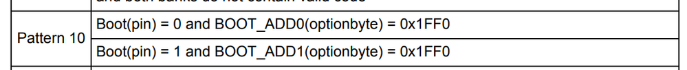

MM..1
Chief III
Are you sure your USART configuration is: 8-bit, even parity and 1 Stop bit
ZSade.1
YES. I use USART1 with configuration on the PC: Boudrate: 115200 8bit EVEN parity 1 stop bit.
the MCU don't reply.
When i SET the BOOT0 pin in the MCU (pin 197) to 3.3V with the rise of the rise of VDD...
then the reset is released from "0" to "1", i try to use the STM software STM32CubeProgrammer.
i "see" the 0x7Fh packets in the RX pin of the MCU, but no response.
In my design i short J9 pin 1 to J9 pin 2 via jumper header before powering up the card.
please check the "BOOT0 PD FOR USART 1" section.
If realy all your bridges transfer parity to MCU pins , then only one next condition
_legacyfs_online_stmicro_images_0693W00000bk1vmQAA.pngrequred is add1 set properly.
ZSade.1
hi MM..1
please be more verbal.
On powerup the "BOOT0" (pin 197) is tied to VDD that is 3.3V ~ "1".
what is the next step to check?
